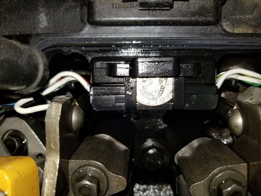

I was having some shuddering/missing problems at high rpms and thought it was a loose injector. When I opened up the driver side valve cover, I noticed the quarter was missing from the UV harness. I think the quarter fell out somehow and is now in the head. Do you think this could be causing the missing problems with my motor? The missing/bucking only happens at higher rpms in my higher fuel programs. I did have some loose injectors and tightened those but after about 100 miles the intermittent problem started back up.

I am trying to pinpoint a reoccurring issue with bucking. I had a bucking problem with older injectors. I sent those in to get tested and Swamps said they were not good. I purchased new injectors and within 50-100 miles had the same bucking. I opened up the valve covers and the injectors were loose. I retorqued them and now 50-100 miles same issue. When I initially installed the new injectors, I noticed the quarter was missing. Not sure if this is creating the problem?? I will check the injector torque once again but this is getting old. Problem is very intermittent, but only happens under hard acceleration sometimes.

I just inspected the passenger side and all injectors were tight. However, the 50 cent mod does not seem to hold as the clip was slightly pushed out. Any tips on how to get the harness clip to hold without sliding out?

Passenger and driver side UVCH. Can this be causing my intermittent problems? The quarter did no help on the passenger side.

I don't think the connection pictured is loose enough to cause any issues. Do you have any burnt pins in the connector? I'm also not sure how the quarter, or any other shim would come out once the valve cover is on unless the clip itself is broken or the quarter / shim is trimmed too small and can drop out the side or bottom.

To fix the clip issue just get the new style harness from Ford.
