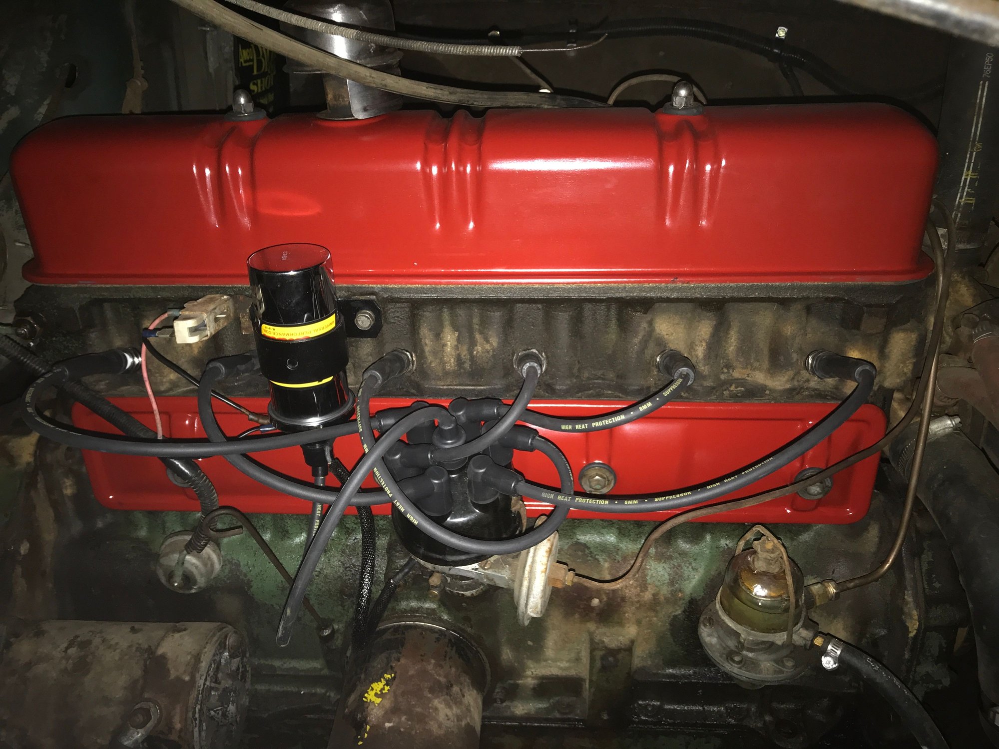

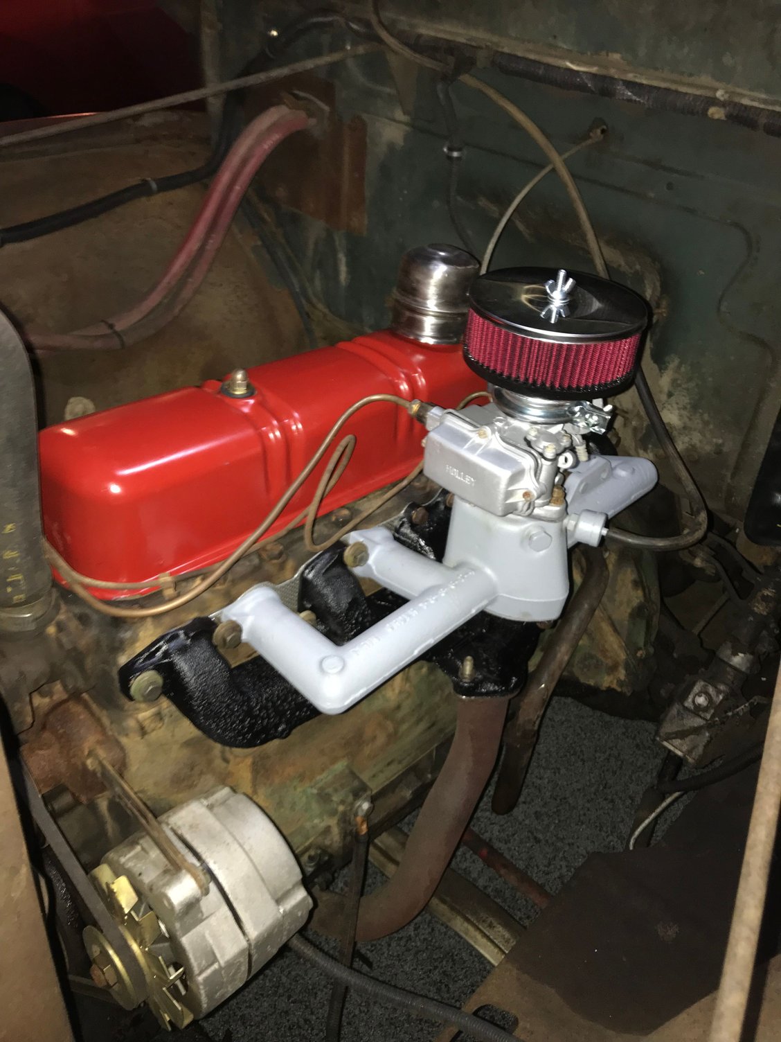

Looking for suggestions an knowledge on battery replacement advice. I have a 1953 F250 with 215 6. It has 12 volt conversion I believe. I don’t get it out whole lot maybe once a week. Rural King 58 R-60 is what’s in it now. I’m recently new to classic truck world so I’m learning as I go. Below are pictures of the motor. I’ve replaced plug wires, plugs, ignition coil, gaskets, cleaned up intake and exhaust manifold and rebuilt carburetor. Added hot rod air filter. Oil bath would not stay on good.

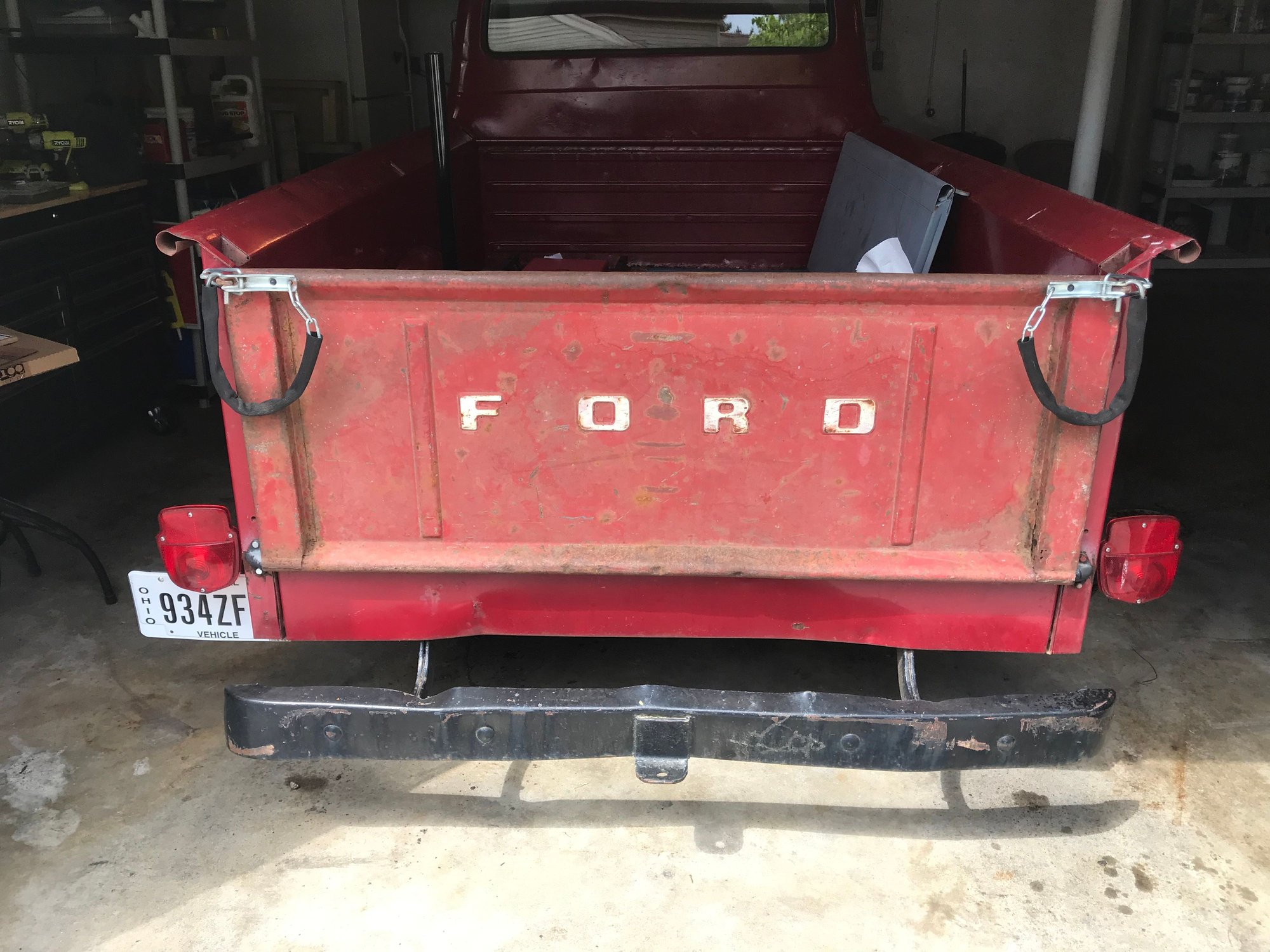

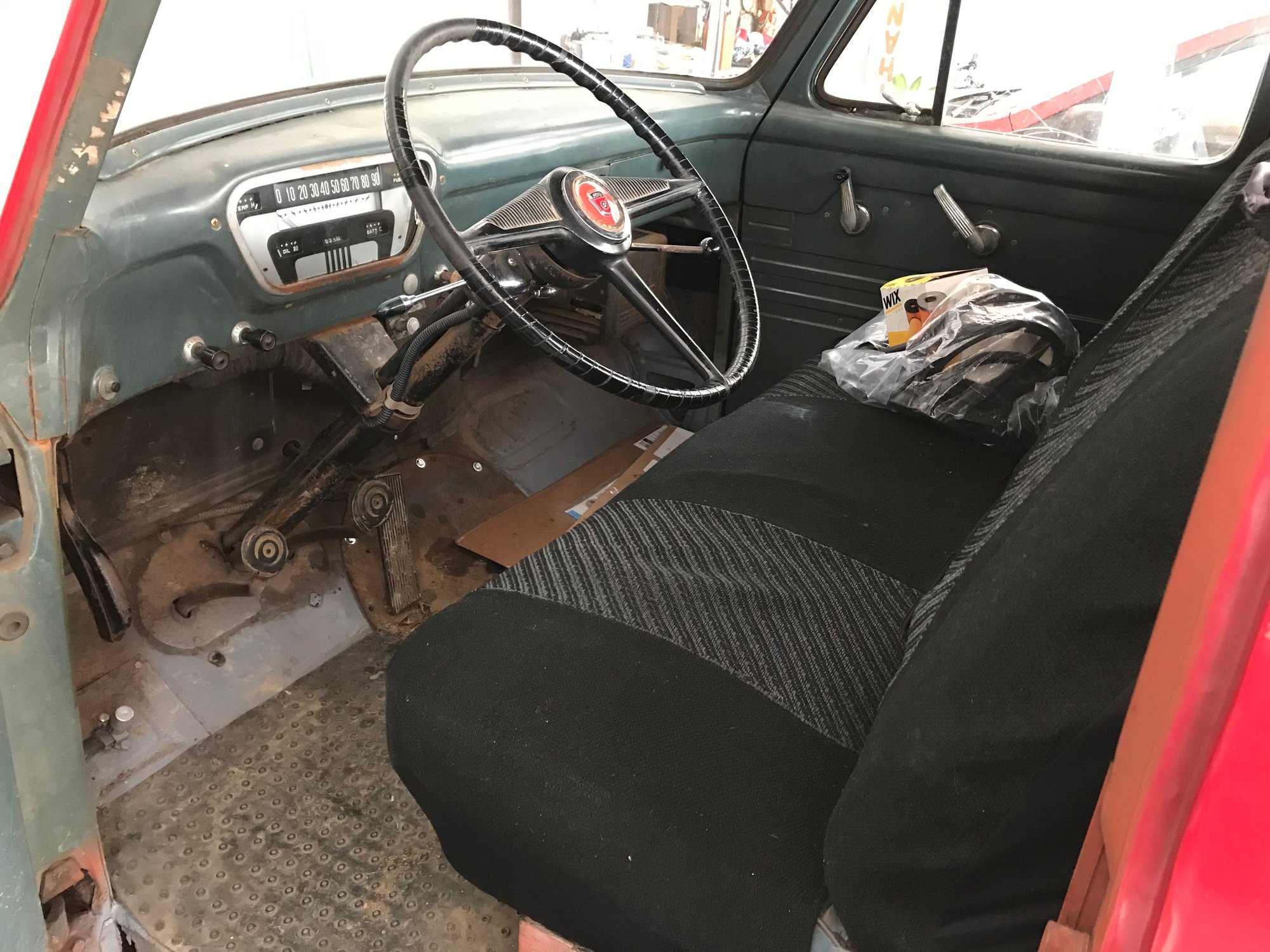

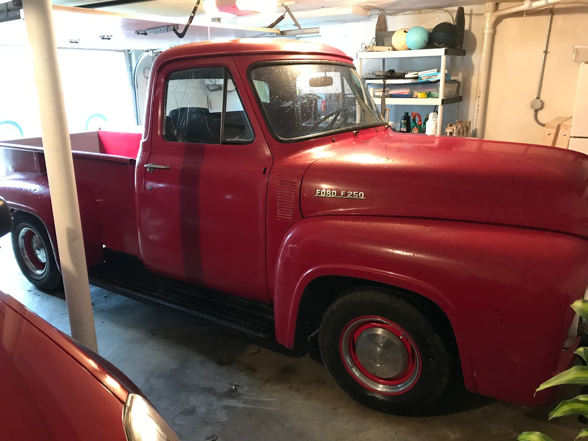

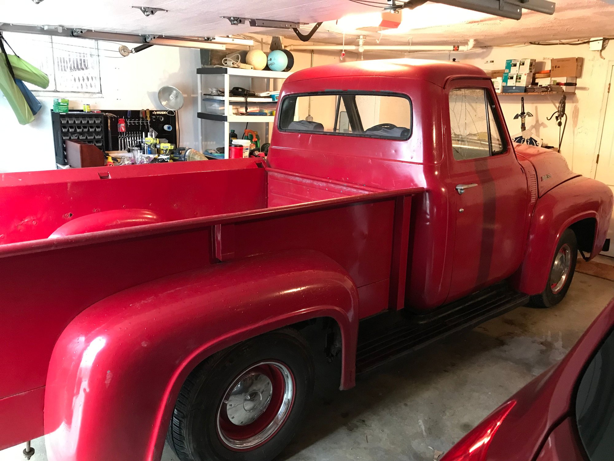

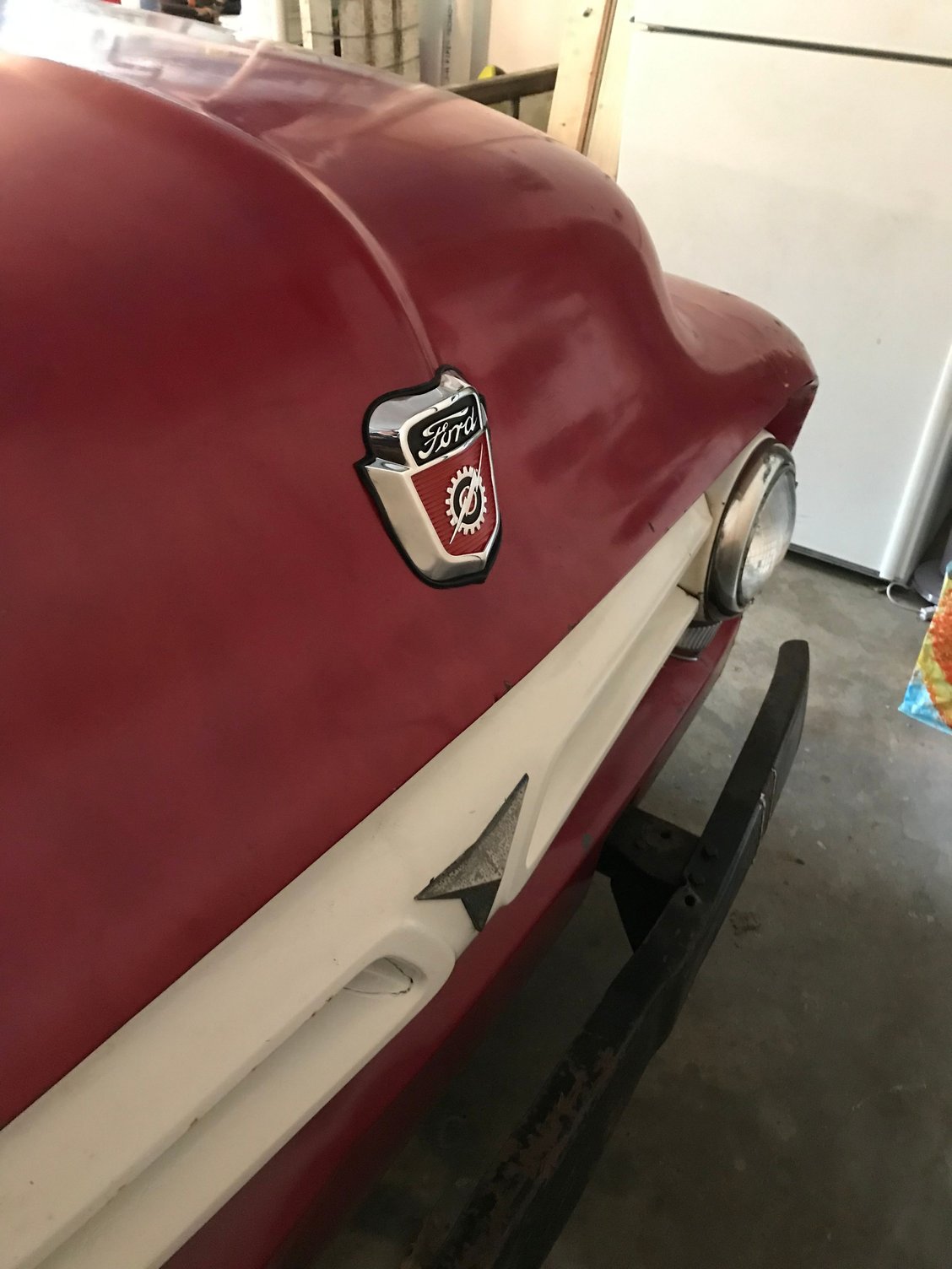

How about some pictures of that truck?

Old Jun 7, 2019 | 01:29 PM

Holy smokes what a great looking truck!
keep us posted on what you come up with to secure the battery. I’ve been looking at that too with the little open box under the floorboard you don’t have a lot of room.
