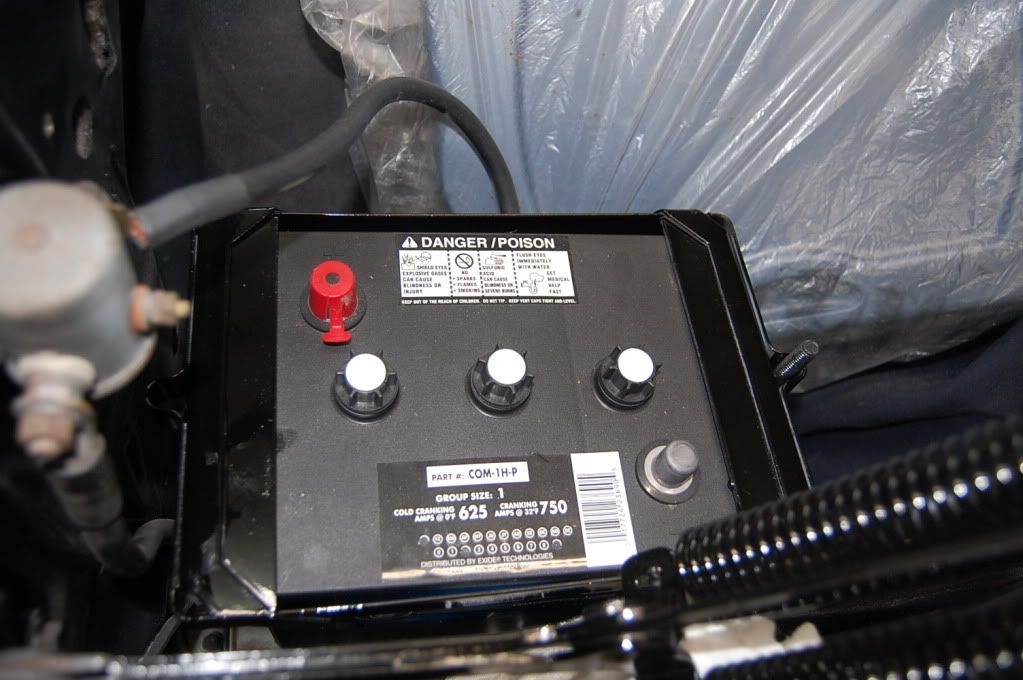

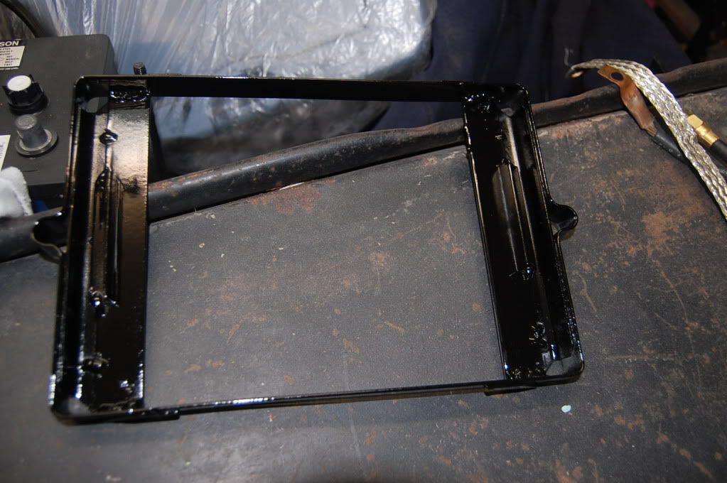

Battery hold down
Old Mar 25, 2012 | 07:54 PM
john fin's Avatar
john fin
Joined: May 2006
Posts: 482
Battery hold down
How many of you have run into this problem. Is it welding time?

Different battery, different hold down, welding time, or bungy cords.
Old Mar 25, 2012 | 08:37 PM
51PanelMan's Avatar
51PanelMan
Joined: Dec 2004
Posts: 7,669
Likes: 13
From: San Jose, CA
Are you sure you have the correct battery hold down bracket? What year is your truck?
I have a repro in my 52 and have since purchased an original. The only difference between the repro and the original is the thickness of the metal. The original is slightly thinner than the repro. I'm also running an Optima 6V battery that is encased inside a proper sized battery box made for the Optima. It's the same size as the original battery.
Maybe you have the wrong hold down bracket??

I just bought a new battery and found out its 1" smaller than the old one, are there redesigned battery trays for other sizes or do I need to break out the 3d printer?
https://www.murdochs.com/products/au...-volt-battery/
Old May 20, 2025 | 04:03 PM
52Flthed's Avatar
52Flthed
Joined: Aug 2019
Posts: 1,360
Likes: 418
From: Monmouth County, NJ
To me it looks like some of these pictures are a group 1 6v battery. If it is it’ll have a ‘1’ molded in the case. The group 1 battery is tell tale about a 1/2 inch shorter and the deck height is lower as well.
Ask for a a Group 2 6v it’s the original size and will properly fit the stock hold down tray.
