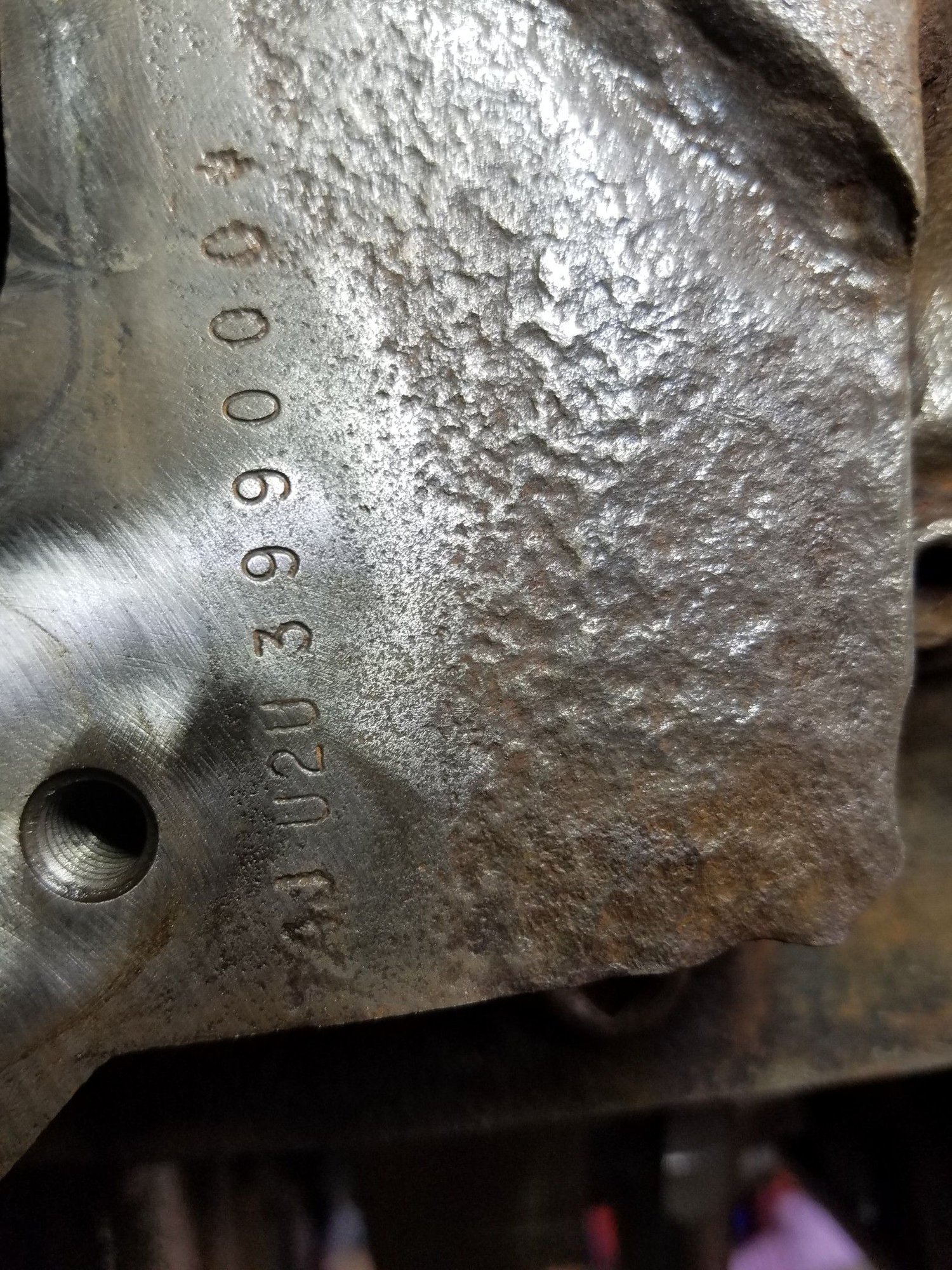

How can I tell if my engine is a reman? As we are taking it apart my dad is suspect, says “this doesn’t seem to be built the way id expect it to come from the factory.”
Thing is real clean and really tight

156k miles isn't really broken in yet
serial number on engine might help out

Last 6 say 399000

Take a picture and post it if possible.
Old Jun 5, 2019 | 01:04 PM
PSU4ME's Avatar
PSU4ME
Joined: Jul 2016
Posts: 546
From: Boston
Here you are

https://www.agkits.com/international...ata-sheet.aspx According to this site you have a 96 build date.

Scroll to the last page. It will show you where the reman tag would be and the serial base numbers
https://static.oemdtc.com/GSB/G0000138.pdf
