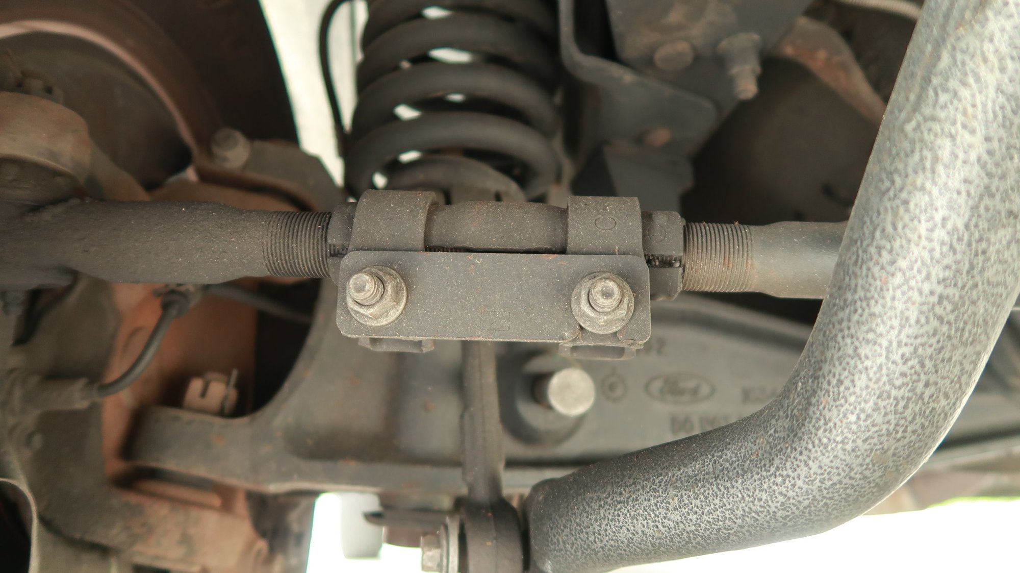

Originally Posted by PrescottIce
It sounds like someone took a shortcut during an alignment. ....
Agree.
I know mine is 2wd, but I think the 4wd has 2 of these, also
These adjusters are for setting the toe-in.
One of the adjusters has right-hand threads, the other has left-hand threads.
The adjuster links are used to lengthen/shorten the linkage between the front wheels changing the toe-in.
Loosen both of them, rotate them the same amount each way and the linkage will stay the same length, but the center link will move right or left depending on direction of rotation.
The steering wheel is connected to the center link and will rotate

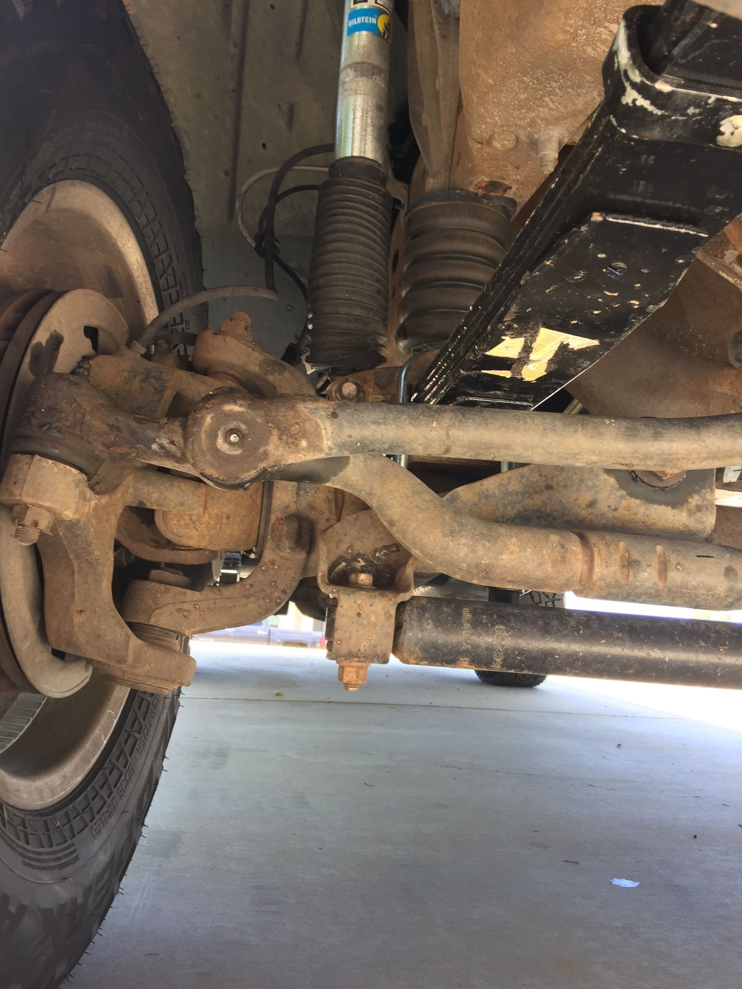

4x4 is different - the drag link connects to the passenger's side tie rod... at least on mine.
