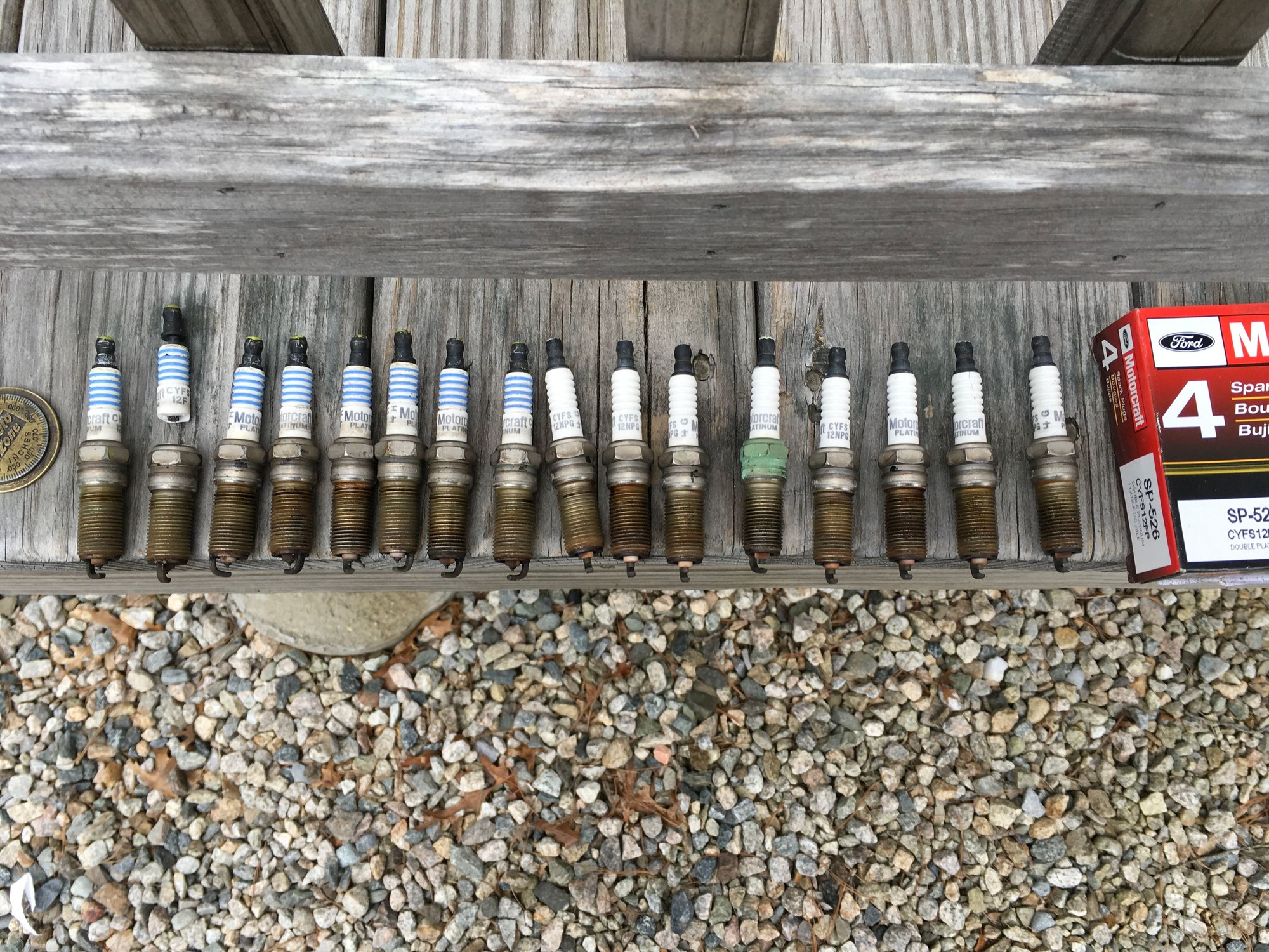

I just changed mine. They all came out easily and threaded back in easy. The ones on top are easy to access. If you have wheel well liners remove them. It makes getting to the bottom plugs a lot easier. Took me about 2 hours to complete the job. It’s simple!

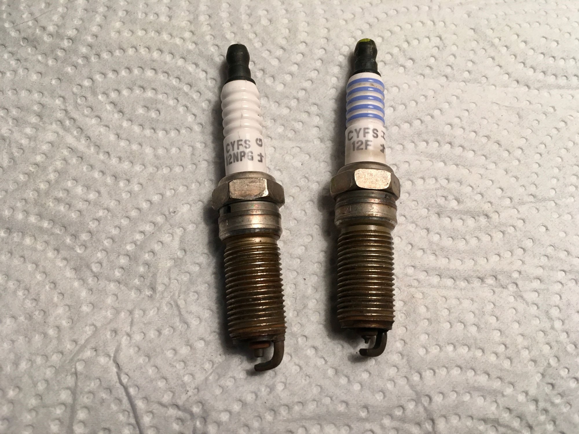

Looks like Ford used copper plugs on top. Bottom plugs had the fine wire tips.

I changed mine at 47k miles. Plugs really weren’t in horrible shape. Top plugs were the worse gap wise but not too bad. No difference in gas mileage or acceleration with the new plugs.

Same with my plugs, 35k miles on mine. 2k hours on them. Top plugs were in worse shape then the bottoms. I changed the top and bottoms to Motocraft Double Platinum. Wheel well liners removed to get the lower plugs

So . . . . are the bottom plugs a different plug than the top plugs?
Old Nov 27, 2019 | 09:42 AM
Qwazert's Avatar
Qwazert
Joined: Dec 2018
Posts: 330
Likes: 26
As far as I can tell, there is only one "type" of plug spec'd by Ford...the Motorcraft SP-526.
