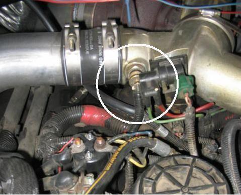

Update, I uninstalled everything and it doesn’t smoke anymore....loose clamp on the back side of the turbo. What I think is wrong, on the y pipe, there’s a screw next to the vacuum solenoid (not sure if that’s what it’s called) that’s missing some wires that controls a spring inside the y pipe.....I’ve looked everywhere and cannot find them. Where do they lead back too or am I going out of my mind?!?

That looks like your intake air heater to me, they usually get disconnected. All they have is wiring going to them.

So then it’s nothing pertinent, right? On another note, I went to move it, and now the stupid thing won’t crank over. I have a loose shifter, so I thought that it wasn’t in park but it was. There are times where the dash lights are dim like a low battery, but then they come on. I just replaced the ICP and still no crank. I hear what sounds like a an air pump behind the passenger battery.....I have no idea what that is. Any suggestions would be appreciated guys
