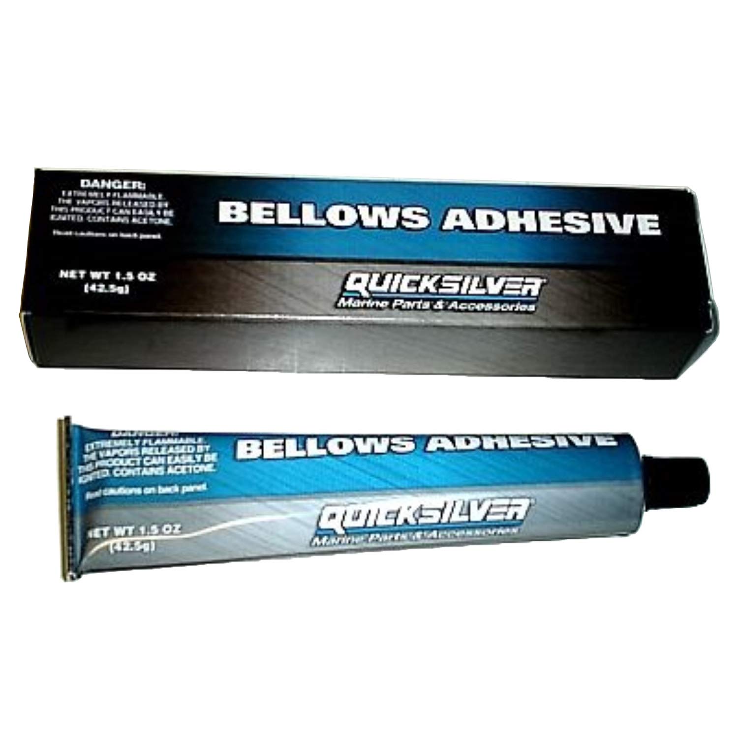

HD Rider: I am currently rebuilding an I/O stern drive and the hose clamped u-joint bellows is apparently famous for slipping off, so this is used at installation in addition to the hose clamp. Wonder if it has an application here?
https://www.amazon.com/gp/product/B001HX9WVM/ref=ppx_od_dt_b_asin_title_s00?ie=UTF8&psc=1 https://www.amazon.com/gp/product/B001HX9WVM/ref=ppx_od_dt_b_asin_title_s00?ie=UTF8&psc=1

That might work.
Hairspray is cheap and it works.
I took my pipes to a local diesel performance shop and had them dimpled with a bead roller.
