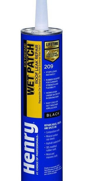

I popped the rubber strip between windshield and the roof. The channel was full of dirt. Blasted with compressed air, steel brushed, soaped and rinsed. Once the channel was dry, I filled the channel with roof patching compound, and reset the rubber strip. I will have to wait for next rain to tell for sure.

UPDATE: The rubberized roof tar is soft and flows well into recessed areas. It does not harden. But it has an issue. It cannot hold in place the rubber strip that covers the channel between roof and windshield. While driving, the rubber strip got blown off and fell into the bed. Now I have to use a real adhesive to reattach the rubber strip. LESSON LEARNED: Don't use what I used.
