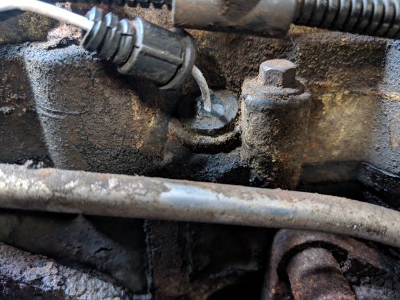

Penatrating oil won't do anything as far as helping. They are made of plastic,
The way I did my stuck ones was to take the valve cover off and use a clean long flat blade screwdriver.
You can see the top of the glow plug when you look down past the oil rail. Slide the blade in-between the top
of the plug and the connector and pry it out.
Here is a vies of the top of the glow plug from inside the rocker box You can see the tail end of the injector hold down clamp.
Here is a longer one that is uploading right now so may not be ready until after 4:30 AM PT
