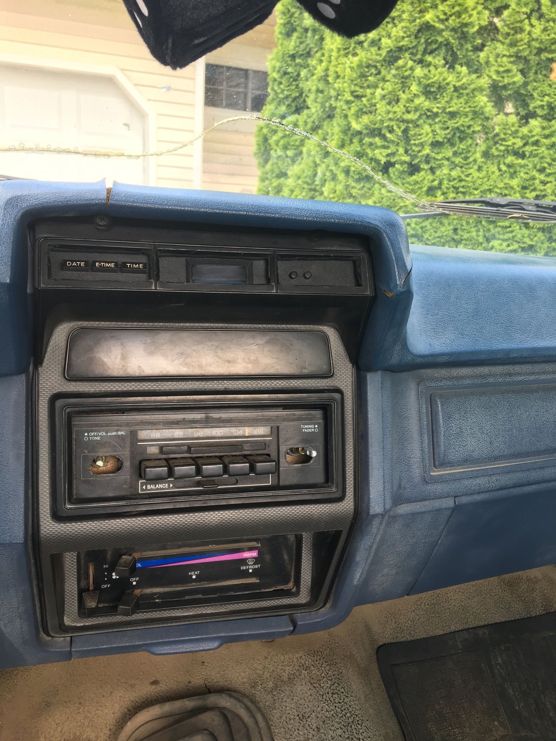

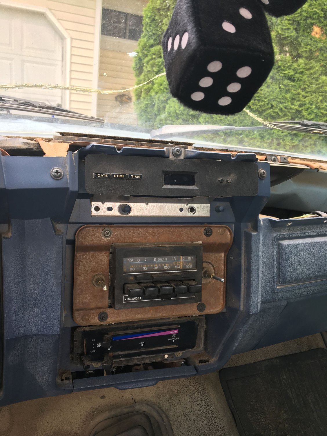

Couple updates, carb is done and she starts right up now. Went to the junkyard the other day and got a clock and a working radio. Ordered some speakers since only the dash speaker works. Need to find some radio *****

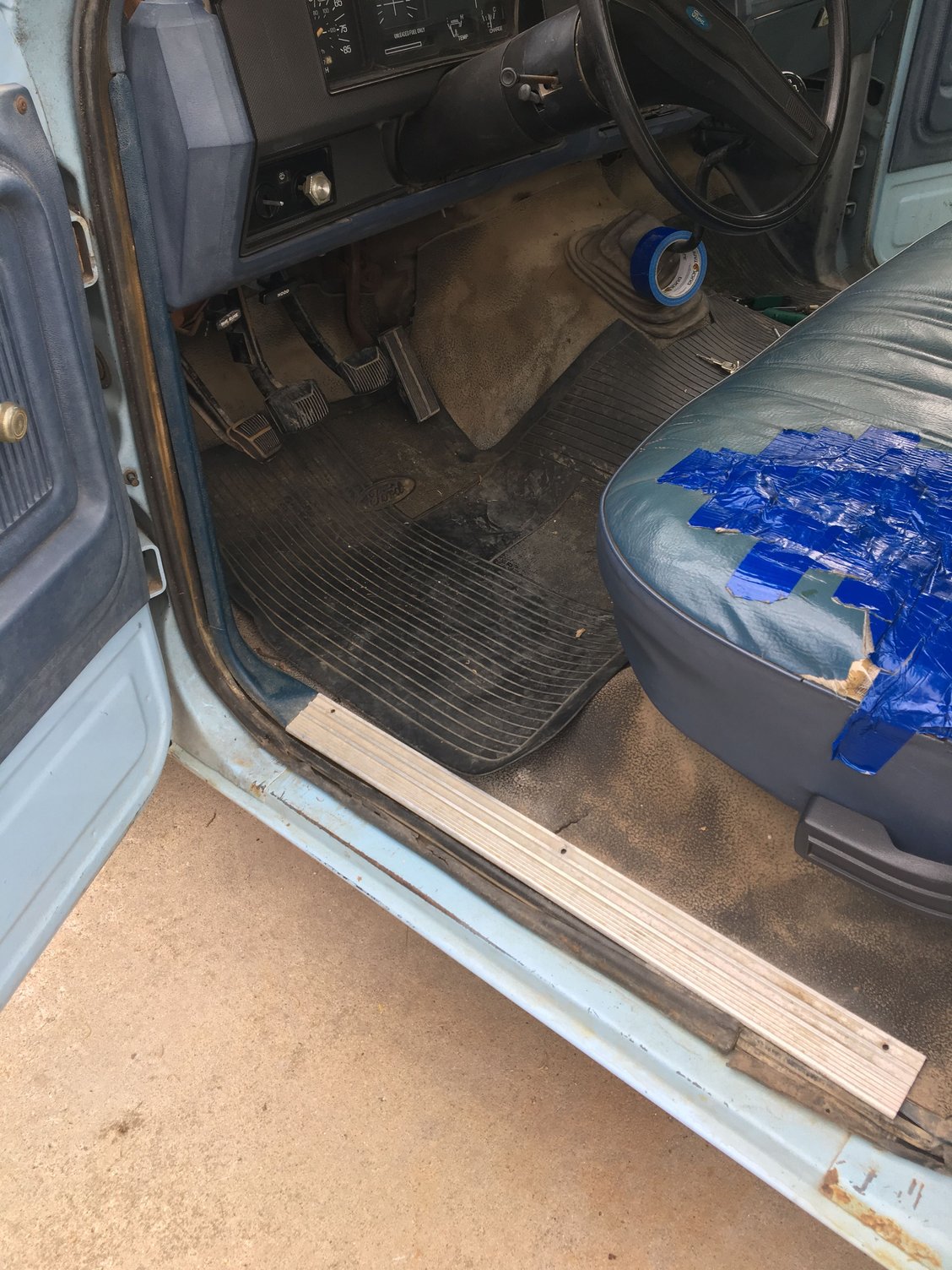

Also found a sweet floor mat

That floor mat definitely is sweet.

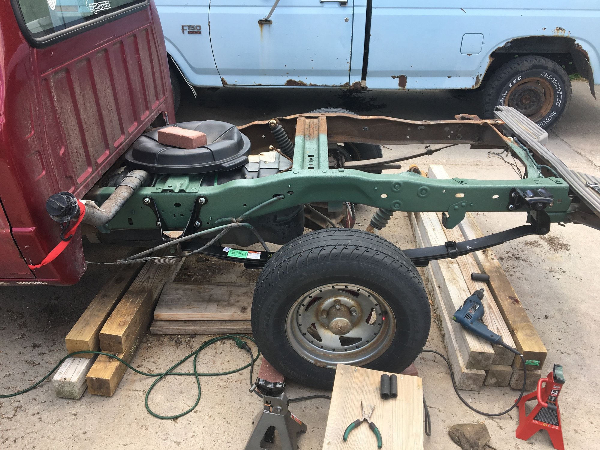

Just about done with Daddio’s Ranger, decided to buy new leaf springs and redo the whole thing. Now onto the next side

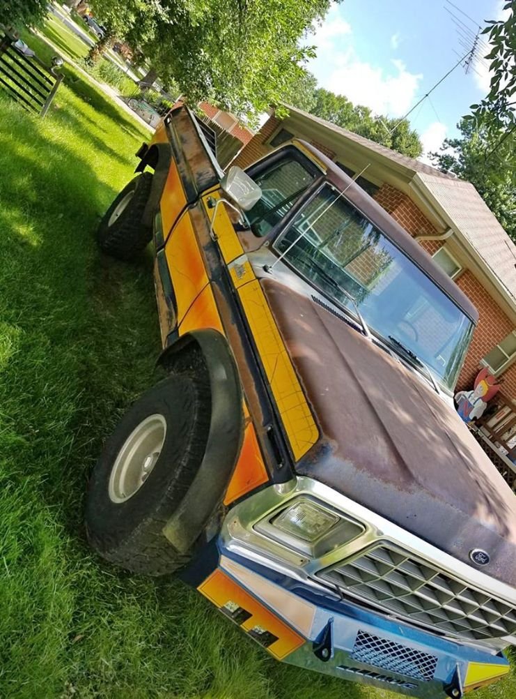

This is for sale near me for $2k, quite tempting
