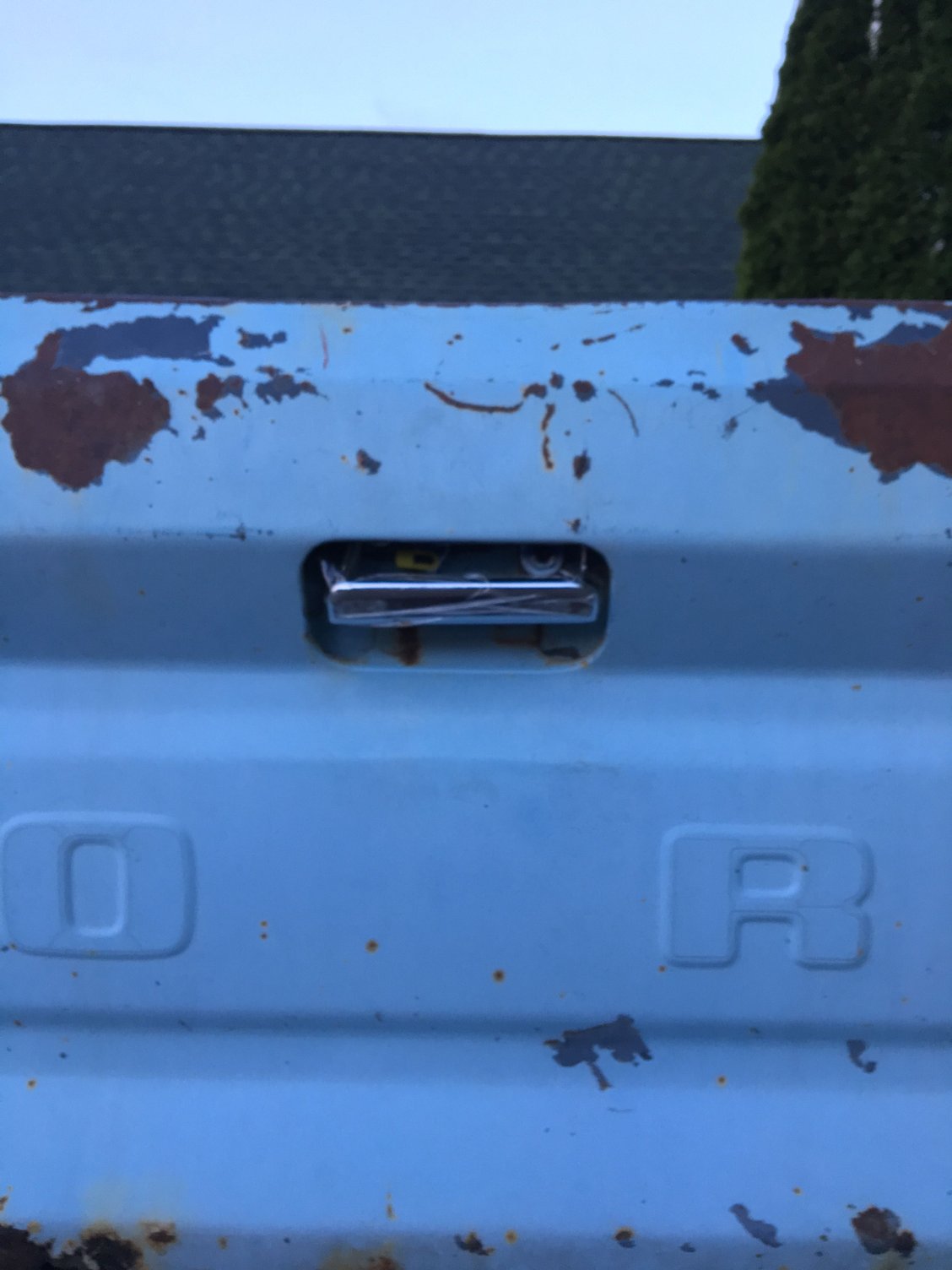

Been busy messing with my trains and work BUT yesterday I went to the big city and snooped around the junkyard and found some bits that don’t help anything but are kinda cool. Still trying to figure out how the under hood light works

Nice finds. The underhood light is retractable, spring-loaded. Mounts under the hood on passenger side close to cowl and connects to single gray plug on driver firewall. Might need some lube in there.

Correct! I have it all hooked up but I don’t understand how it turns on/off

Make sure black wire grounds to hood and that hood itself is properly grounded. I think the act of pulling the wire out will turn it on. Not sure.. also check bulb.

I got the under hood light working and also my tailgate works now!

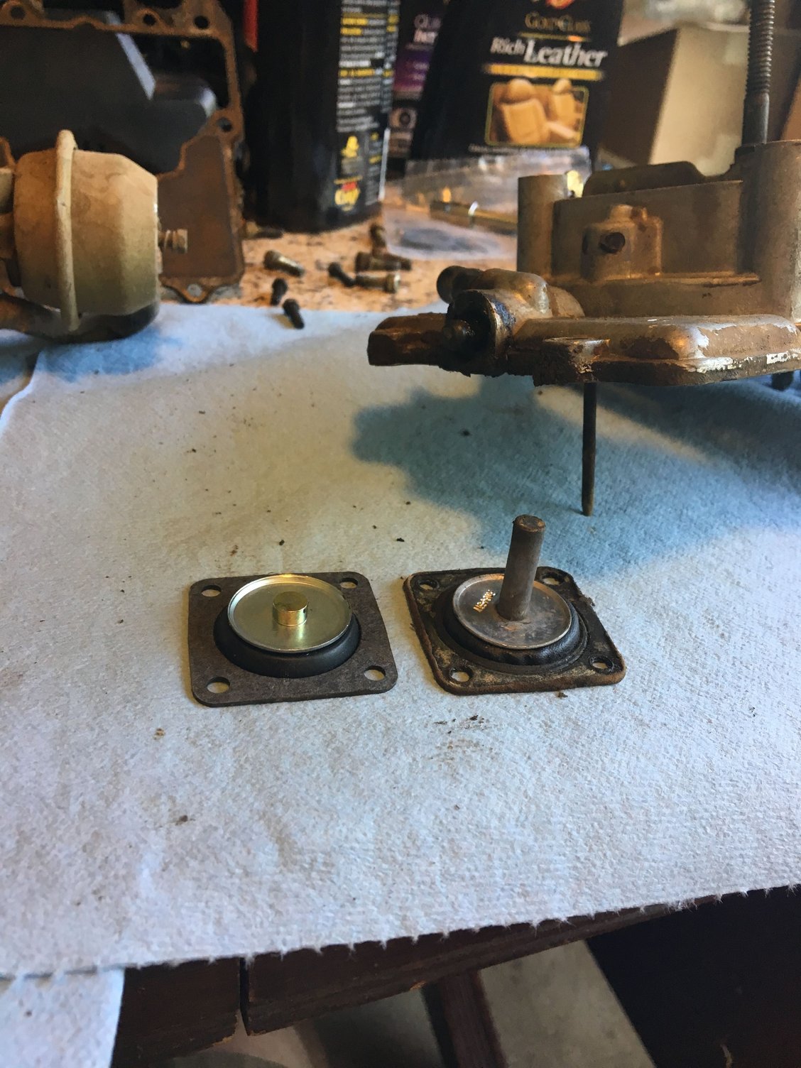

I’m finally getting around to rebuilding the carburetor but I noticed these are different, is that an issue?

Very much so, what's the pump cover look like?

Apparently that’s for the 2.8 L engine and it only came with that one. Great start...

I got it figured out! There was an add on stem in the bottom of the box. Next question, does this port just need to be closed off?
