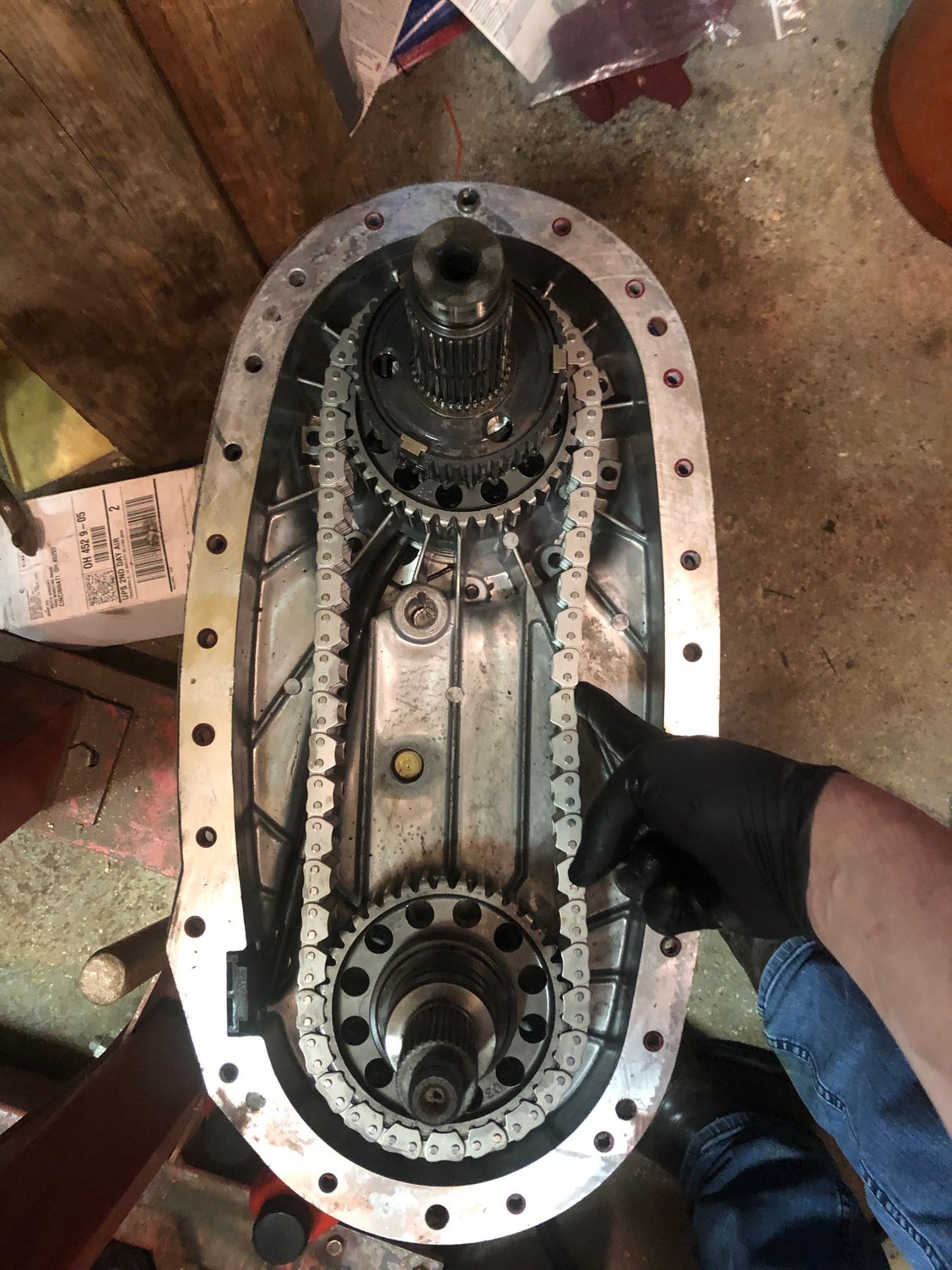

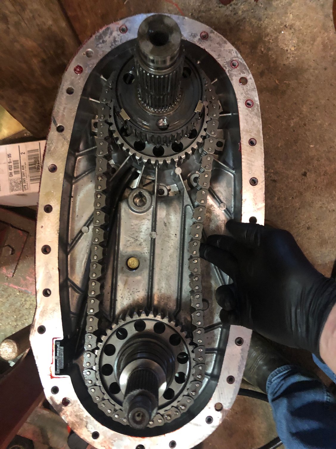

Got my new chain and installed it. It’s definitely tighter, and it was a bit tough to jockey it into place. It’s fairly stiff compared to the old one and has probably 1/3 the slack the old one had.
New chain
Old chain

Less than expected, so i would say old wasn’t too bad

Absolutely worth doing since you're in there to install your conversion input shaft anyway. Not a time to skimp. Good job.

For sure less than I thought it would be, but super glad I did it. I don’t have a need for a blown up transfer case, and so much easier than having to take it out later and do it given all the work I’m already doing. I’ll do a full write up on the I put shaft change as well.

Yours was stretched, but i also wonder at what point is it stretched too much

Exactly....and with the number of miles most folks are getting on this era of vehicles, it's definitely worth the new parts.
