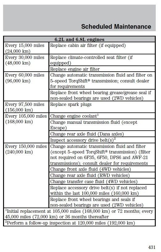

Originally Posted by KenRebF-250
However, I've looked everywhere I can think of and can't find any mileage parameters for TC drain and refill.
I just checked my OM and they recommend changing the TC fluid every 150,000 miles during "normal" use and 60,000 when towing. Personally...I would do it a LOT more often than that; Mercon LV isn't that expensive.

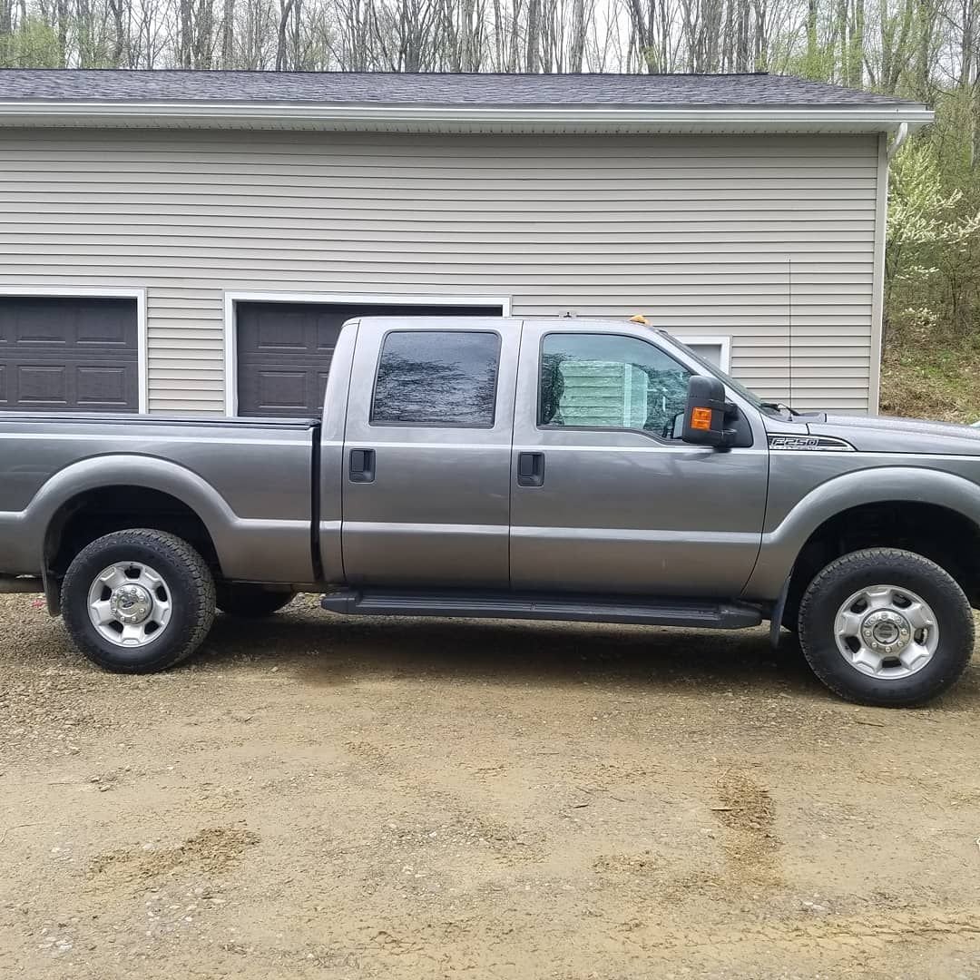

I am going to order a case of the LV fluid, will that be enough to to the transmission? I am gonna drain the fluid and change the filter. Or is 12 quarts not enough? I think the om says 18.5 or 16.7. Is that completely empty or what?

Thanks for all of the help!! I ordered a case of LV fluid and a new filter. I was going to put the truck up on my 2 post lift to do the fluid change and realized I did not have high enough extensions to not hit the running boards.So I ordered those and now need to take some time to do it. I have more questions but I will start new threads for those.
I just did the transmission service (filter+fluid) today as well as the transfer case fluid.
I did it with the truck on the ground on its wheels. It's not that bad that way.
