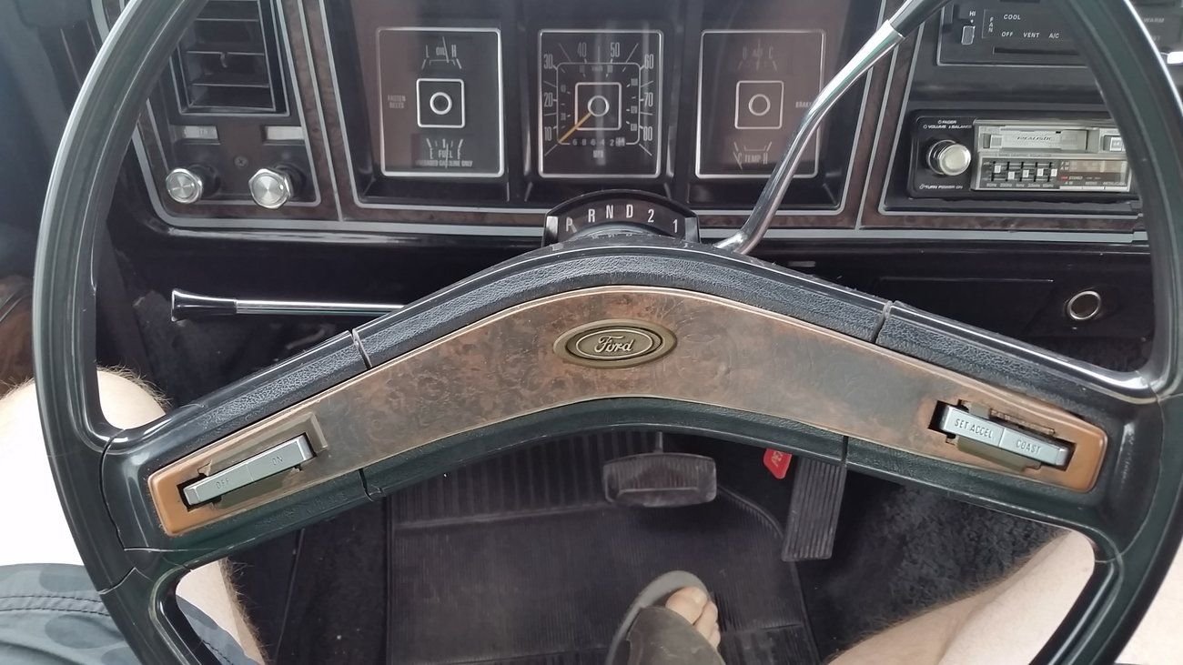

Mismatched Steering Wheel Help
I’m thinking my 77 F250 has the wrong steering wheel. Doesn’t look right and it does not go on far enough to make the horn contact so horn doesn’t work. It looks like the original column. Can anyone confirm if this is a later wheel or? Thanks!

The wheel is similar to the one on my '76 F-250, but I don't remember that large "gap". I'll recheck. Bill (NumberDummy) will probably know the answer.

That is the wrong steering wheel for your steering column. It is a 78-79 steering wheel.

Originally Posted by Mark8man
My 77 F250 has the wrong steering wheel. Doesn’t look right and it does not go on far enough to make the horn contact, so horn doesn’t work. It looks like the original column.
This is a 1978/79 F100/350, Bronco and Econoline steering wheel and horn pad (horn pad used without Speed Control).
The correct steering wheel and horn pad: 1971/77 F100/350, 1974/77 Bronco, 1975/77 Econoline except 1975/77 F100/350/Econoline with Speed Control.
Two different 1971/77 horn pads without Speed Control: Black camera case finish (Custom/Ranger), walnut wood grain finish (Ranger XLT/Bronco Sport/Econoline Chateau).
Both of these horn pads are repro'd by Carpenter. The 1971/73 wheels were available in colors, but in 1974, Ford replaced them with a black steering wheel (D4TZ-3600-A).
Carpenter repro'd the black steering wheel, but the last time I looked (about 6 months ago), he was out of stock.

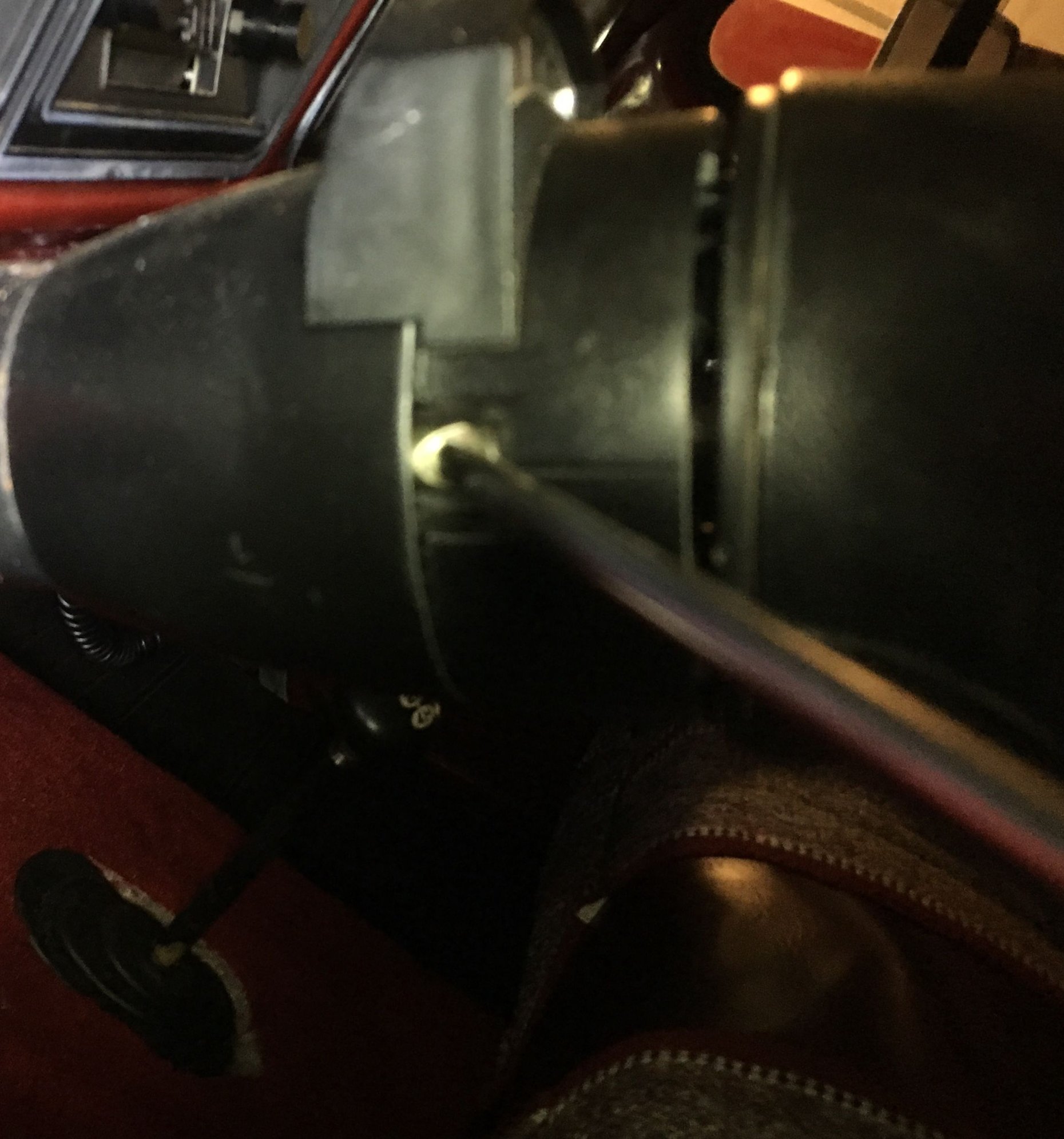

True 77 has the metal piece spring clipped or screwed (?) under the steering column, yours looks to have it. A 78/79 has a plastic piece that is screwed to the underside of the dash. So you have a 77 column and looks like you have a 78/79 steering wheel and horn button. A 77 steering wheel has a smaller horn button that sort of mounts inside the middle section. See pic 1 and 2.

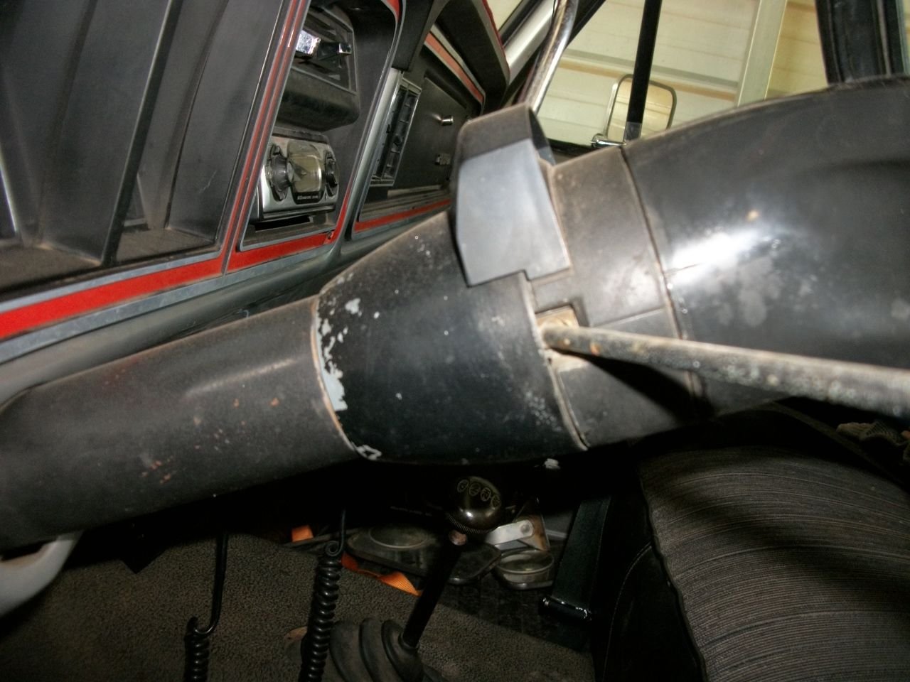

On a 78/79 the horn button and pad cover the complete middle section. See pic 3 The incorrect steering wheel could be your problem. Did you pull the horn pad off (remove 2 phillips screws from the back side) and see if the horn wires are even connected?
I seem to remember that on the older it is a 2 wire connection one slips on and one is like a U clip that goes in a hole in the middle. The 78/79 had 2 connections. Even more in a curved plug, if you have cruise.

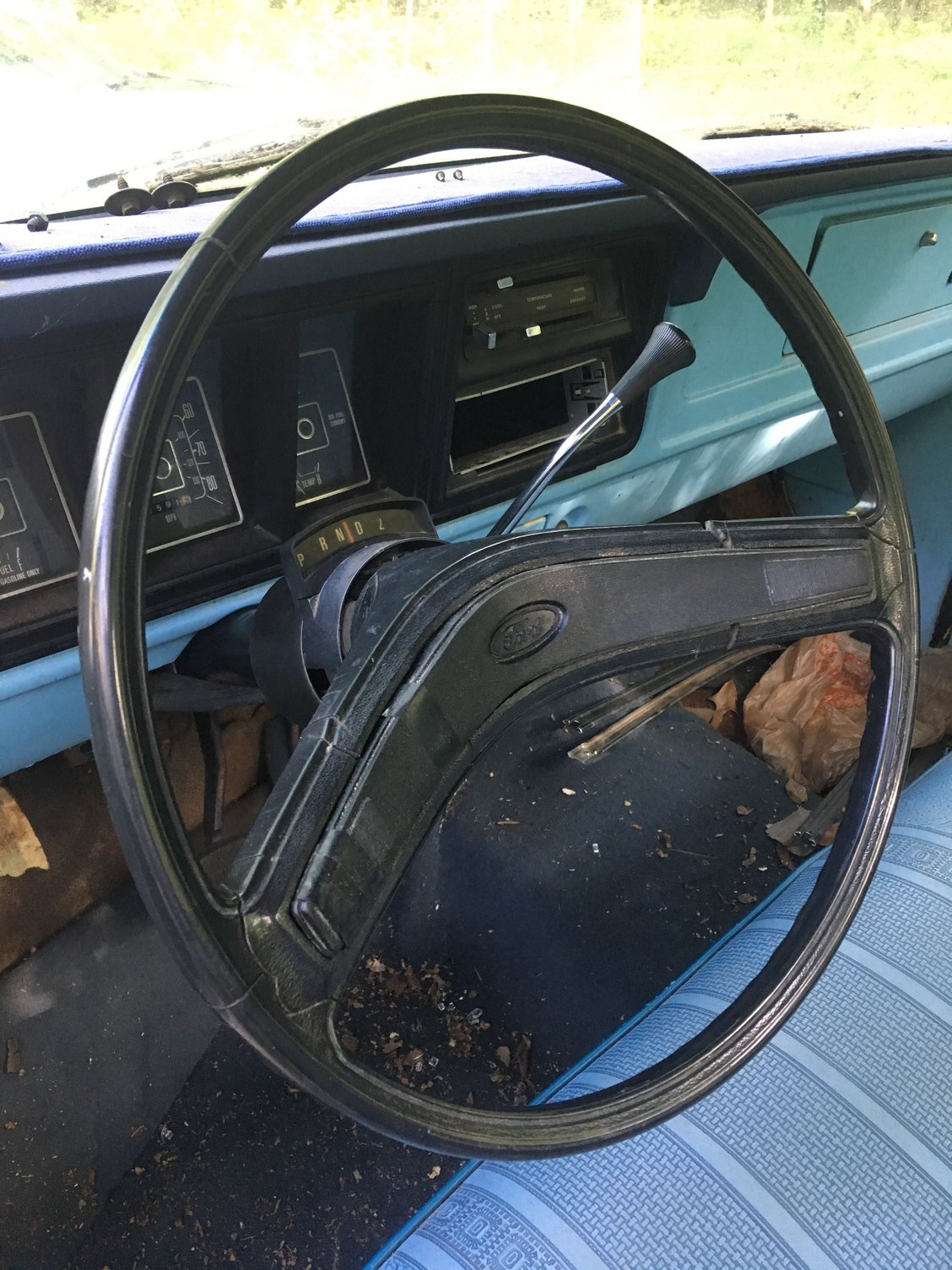

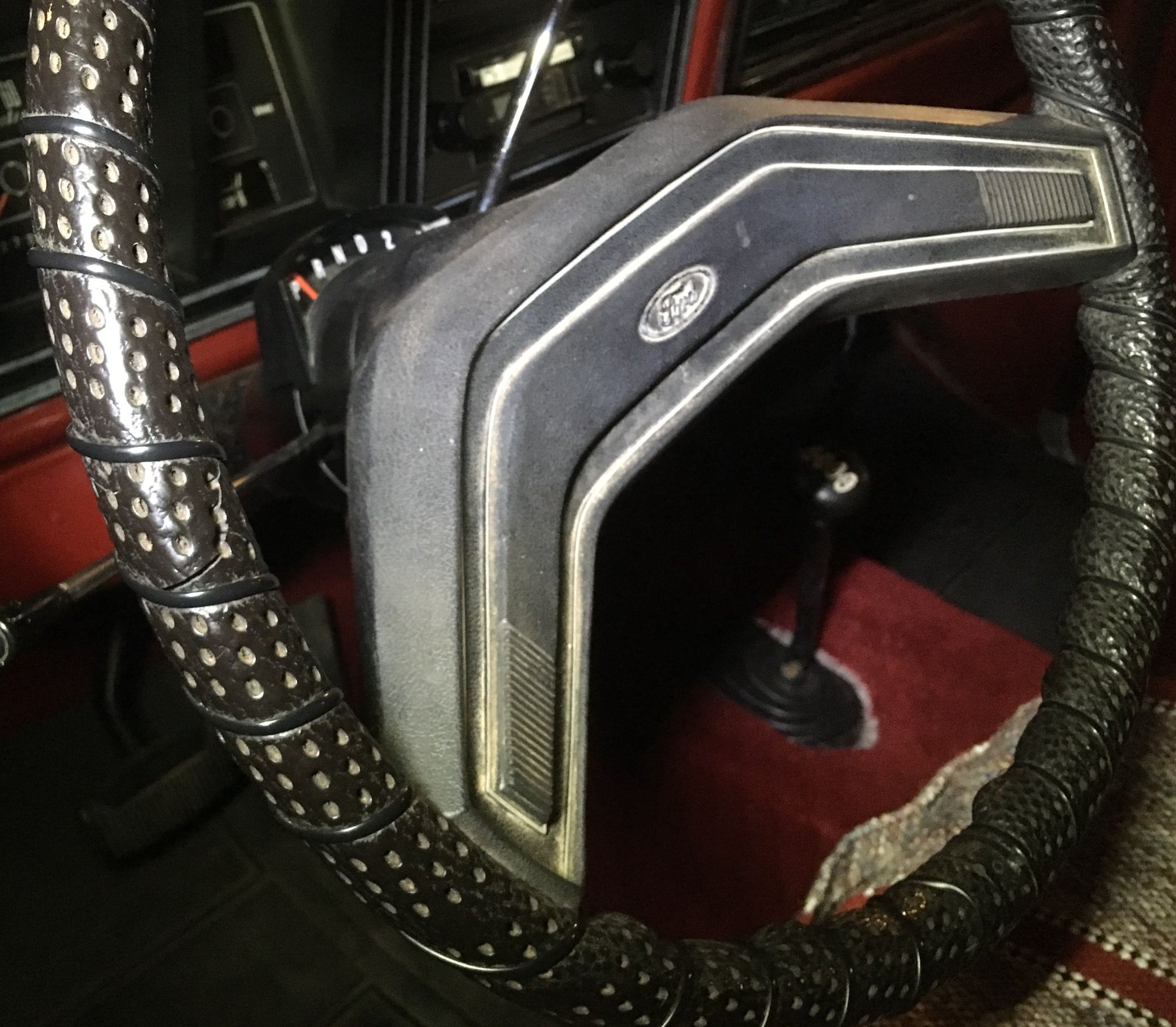

Also your 77 should have a smaller diameter steering column, all metal exposed. And here is an even better idea of the difference in horn pads.
