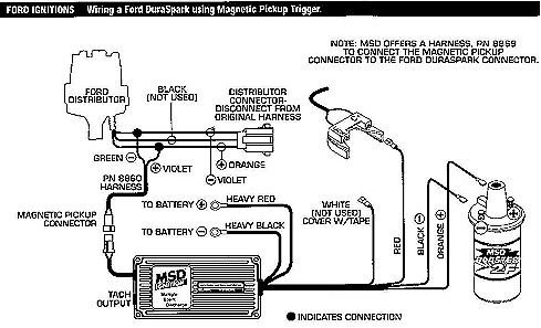

I've looked at the pertronix but there doesn't seem to be a ignition box that will work with it. I would like to find something that will work like if you had a msd distributor and msd box.

I just looked at the manual for the Super Sniper and they recommend a magnetic pickup style distributor. So a Unilite is out(because it is photo optic), but any other should be fine. They are all hall effect designed. They just list a + and - wire for the distributor and this is what MSD listed for their system using a Duraspark:
That $60 Cardone I listed should do fine and give you all new parts.

Awesome thanks for the help!
