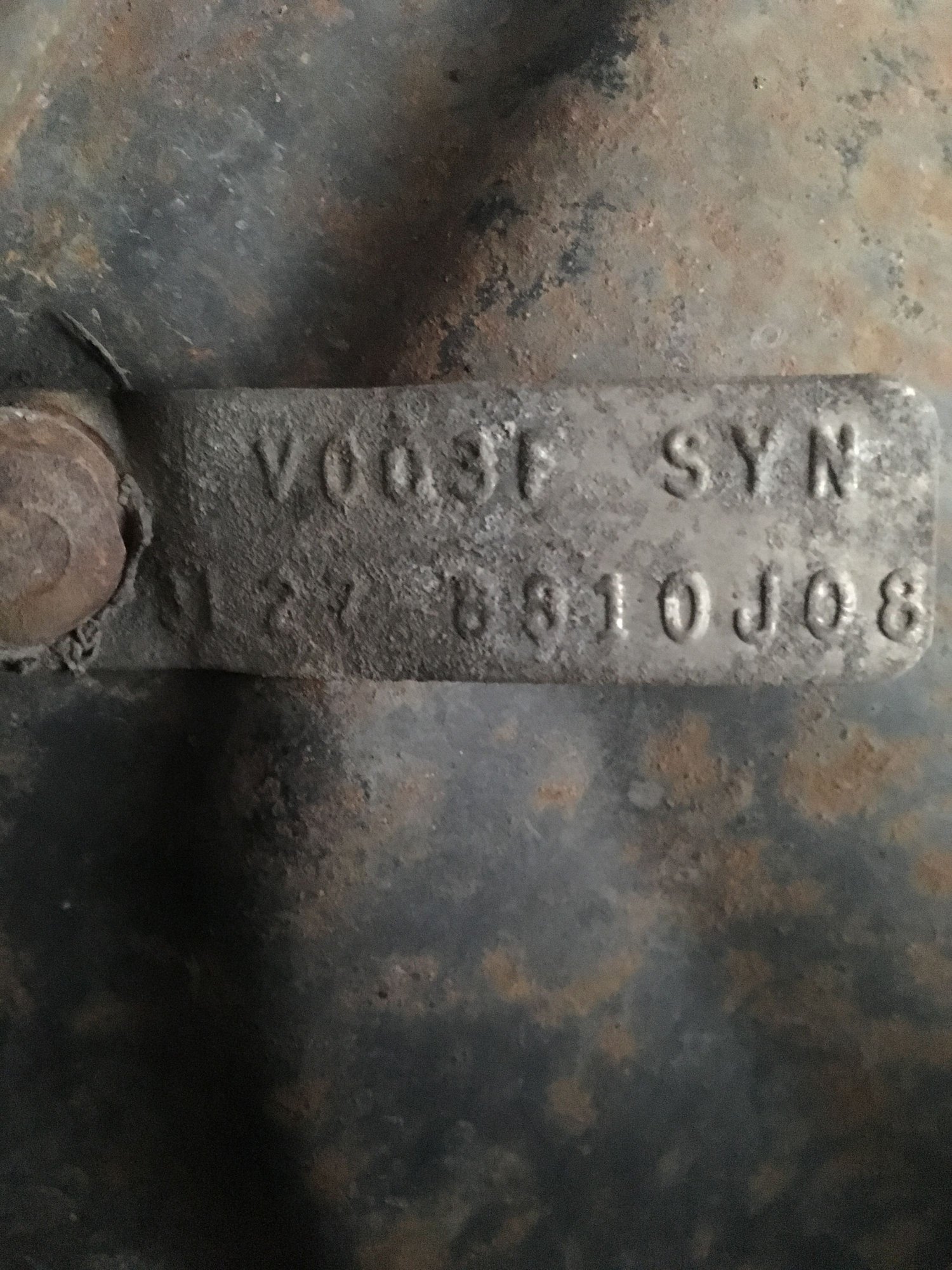

I have a '11 Crown Vic with 300k miles on it and my rear diff fluid looks like this...
Been watching some utube vids on how to change this fluid out but after a visit to the local Advance store I've got some questions. Up til now, forums on the net have led me to believe that all former police cars (which is what mine is) need 75w-140 fluid with friction modifier, but after giving them my VIN at Advance the computer comes back with a fluid suggestion of 80w-90.Here's the diff tag...
I believe that shows a 3 (L or 1)? 27 which indicates a 3.27 gear ratio, and then an 88 after, which indicates the 8.8 axle. Not sure what that SYN means, unless it means synchronous?

Not familair with the 11 crown vic but unless you've had the car since new you can only assume the rear axle is original. It probaly is but I wouldn't trust any of the computors in these chain stores. I know on my SD I went through this confusion and there was some coding which I forget now. . I would guess the SYN would be synthetic but I've attached a ford chart. I think it has answers to what you have found on your axle . https://www.fcsdchemicalsandlubrican...axlelubeUS.pdf
It indicates the higher priced oil you knew about. Though it may or may not be needed now , it's 100k stuff. If it's original, it did it's job well. I know the price of it floored me but I had no choice on the SD. I also got mixed advice on Motorcraft brand and adding the modifier over other brands , Valvoline, Mobile One etc, with the modifier in it. Simply went with the store bought basic brand name over running to a dealer. Still pricey, ran me $80.00 plus the cost of liquid gasket doing it myself .Saving on price was only on the cost of the additive which wasn't much. I'd just pull the cover and let it drain off real good. . I'd be careful about disturbing too much if everything in there looks halfway decent. But that's probably just me and the if 'it ain't broke don't fix it' thing I've learned over the years. It should be a LS and the additive is/was put in there for a purpose.

put the proper gear lube in with the proper friction modifier.
your car has a 3.27 geared limited slip differential.
