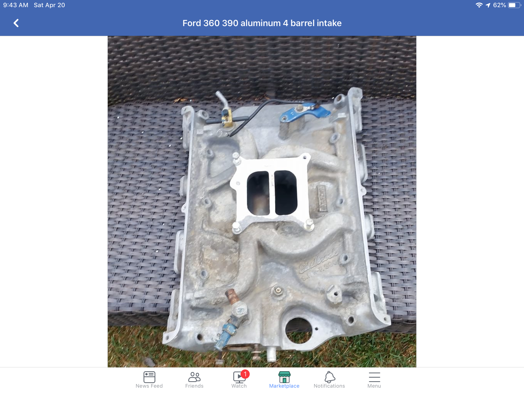

I found an intake for sale and I’m wondering it it’s any good. I want to use it on a 69 360 motor. Any info is appreciated. Doug.

Not a great manifold. Search by that sp... number and you will find a thread on it hear from a while back. I will post a link later.

If it's the Performer, then it's not much better than a stock intake. If it's the Performer RPM, it's a pretty good intake. It won't have an exhaust crossover, so the crossover will have to be blocked at the heads.

Not a Performer or Performer RPM.
It's this turkey:
https://www.fordfe.com/edelbrock-s-p...ld-t28913.html
https://www.ford-trucks.com/forums/1...-question.html
If you are just needing a manifold on an otherwise stock motor, it would be an acceptable replacement if it was nearly free.
Otherwise, Performer RPM.

Ok thanks for the info. I will stay away it. I really appreciate all the knowledge that the members have on this site and the quick response. , Doug.
