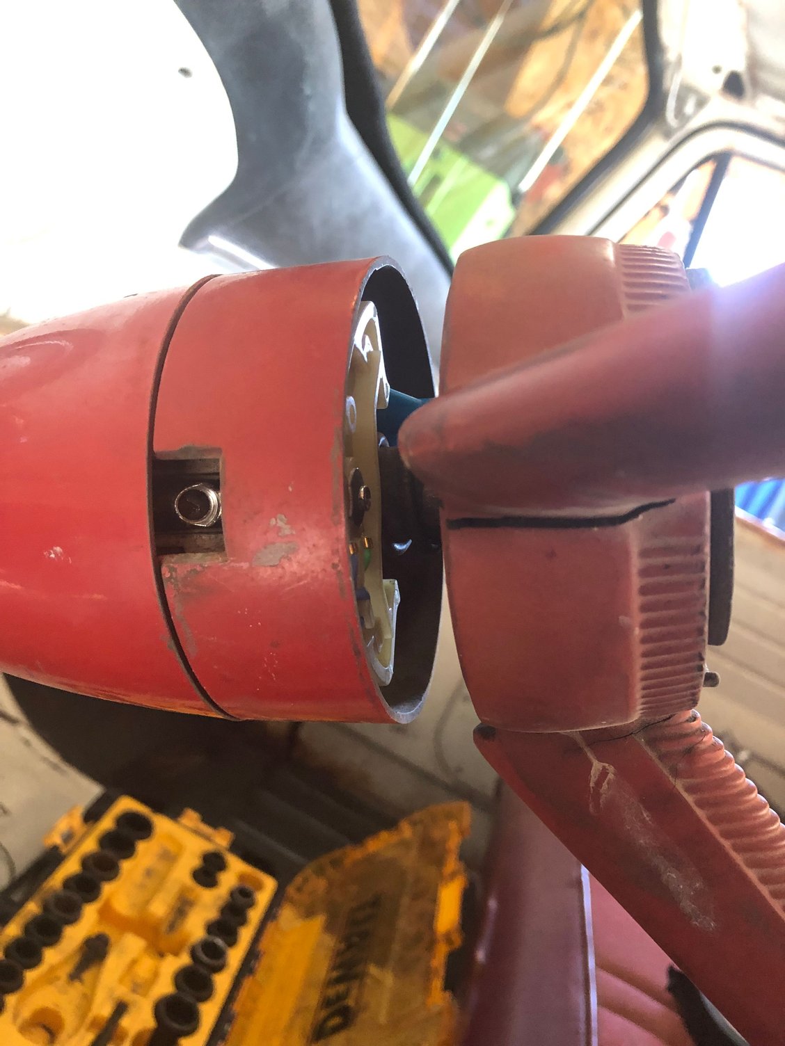

Hey guys. Was replacing the signal switch in my 66, and noticed the steering wheel is about a half inch higher than what it should be. Is there something that can be adjusted so the shaft will go down?

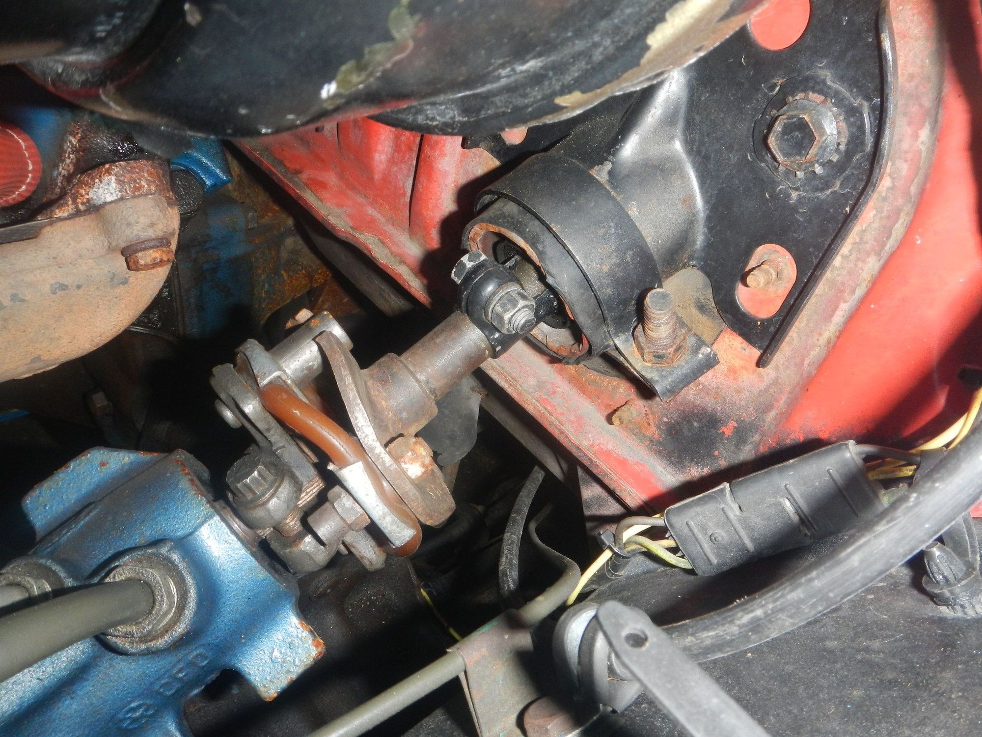

That much gap tells me that the lower steering shaft bearing is toast, The lower bearing retainer did not just come loose and allow the column to slide on its own. If you look down there and that retainer is up in the tube you have a problem.
This is what it should look like.
