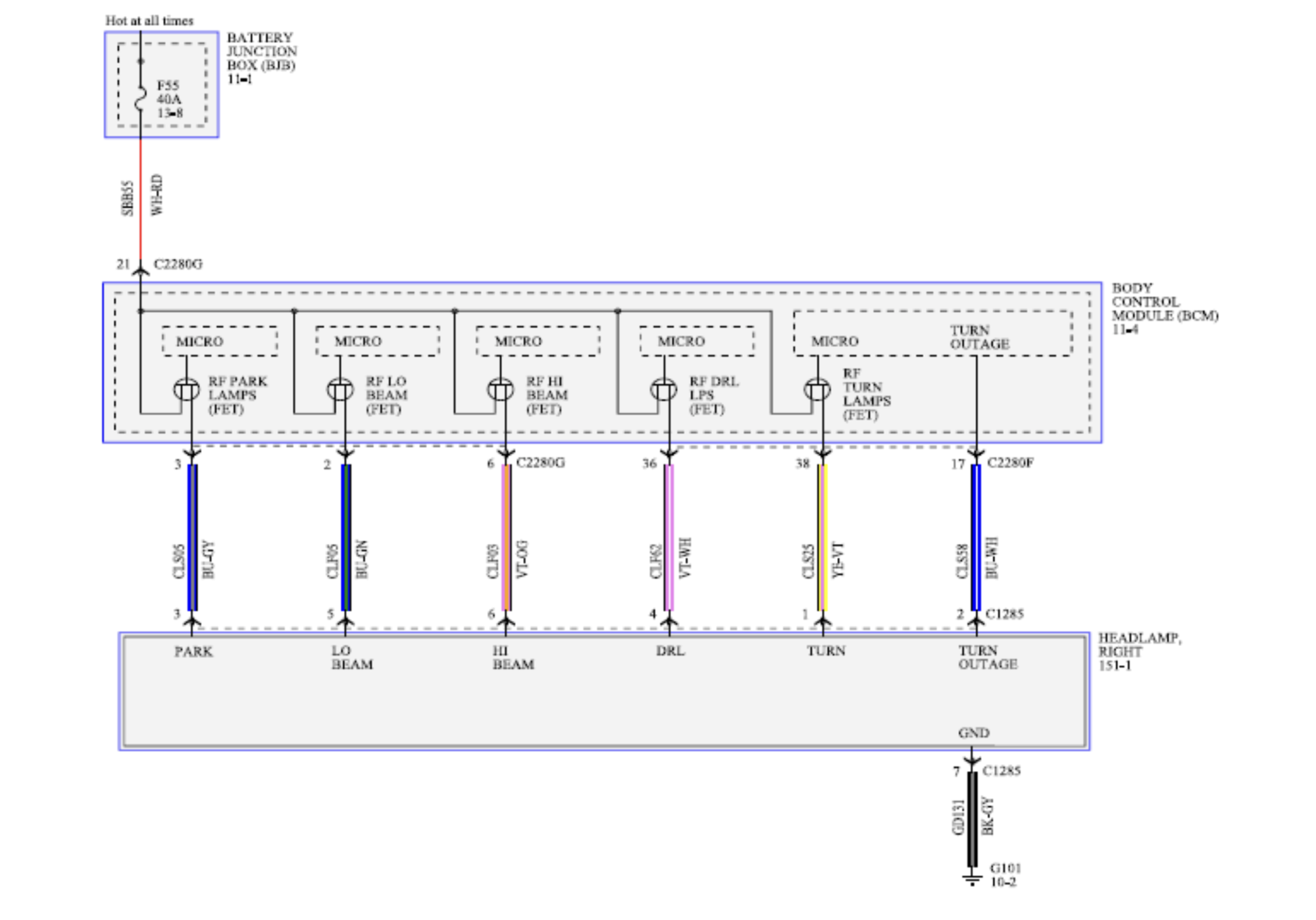

This one of the first threads I’ve seen of a factory LED headlight going out. However, since all the lights in the housing are dark.....that should mean the actual LED didn’t fail. I won’t swear that I’m right, but I am not aware of the factory LED headlights using a ballast.....at least I didn’t see one when I was in there adding to the harness.
I would suspect one of two things.
A. The moisture in the headlight caused a short on one of the circuit boards
or B. You have a wiring harness or body control module issue.
I would test the wiring harness before buying a replacement headlight. Below is a pic of the pin identification for testing the harness. This will at least confirm if it is before or after where the harness plugs into the headlight housing. Note, this is specifically for the Right headlight, which is the passenger side.
After testing, if you do determine the headlight has shorted, you can try a Hail Mary operation...as a last resort. This would be drilling a couple of 1/2” holes in the back of the headlight housing. You would do it in such a way the filings don’t fall into the housing. Then, you’d use a hair dryer to blow through one of the holes so the air escapes from the other. Once it’s thoroughly dried out, seal up the holes and test it. If it works, make sure the factory vent isn’t coated in mud or debris...which could be the actual cause of the moisture buildup. It’s a hack job...but, what the heck if you were going to toss it in the trash anyways. This will only work if the moisture is causing a wet short....not if the short fried any electronics.
