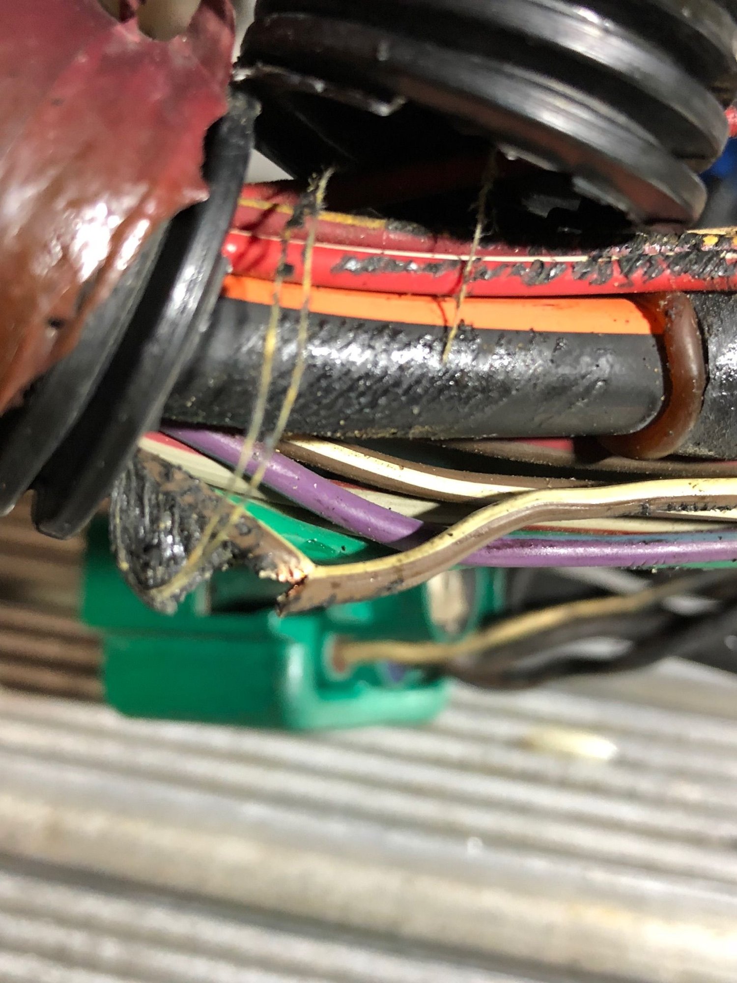

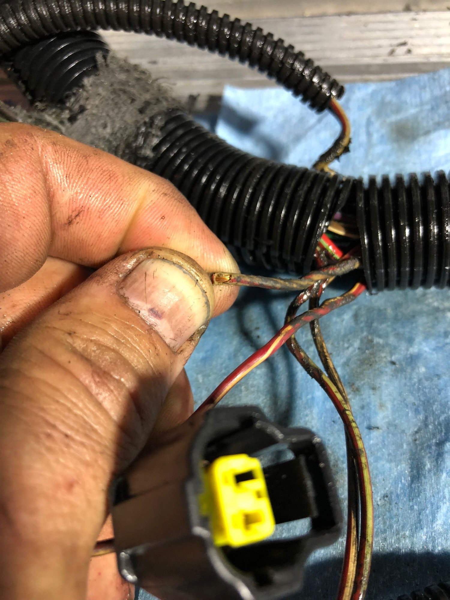

See if I can post pics now....
this was a small small and not broken all the way through but when shorter to the other broken and bare wire next to it cause all sorts of intermittent problems and all the OMH and voltage drop testing never turn up a thing.
point being..... be through in your investigation.

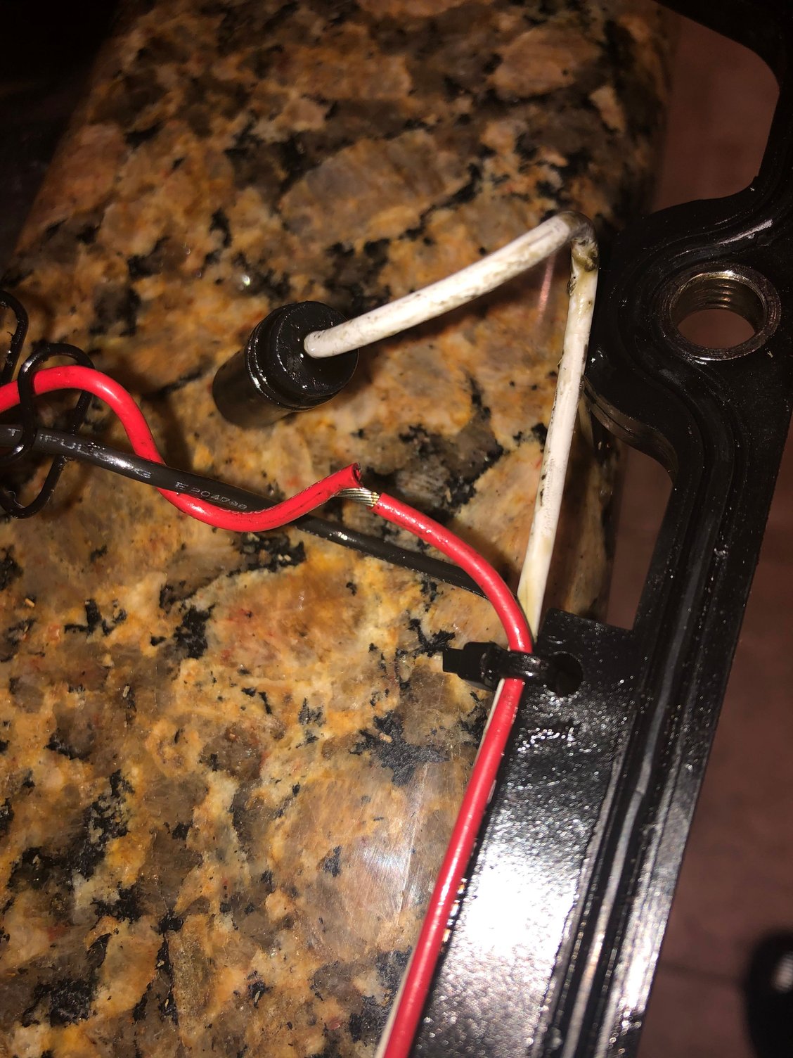

I looked really closely at the wiring harness and did not see any chafed wires. I ordered the valve cover gasket and harness from riffraff. I took it all apart this afternoon and found an exposed wire under the valve cover. It was on injector 2. I almost jumped for joy. I took out the gasket, installed the new one. Plugged in the 42 pin. Buzz test paassed. Ran it four more times. Passed, passed, passed, passed. I climbed down from the top of the truck and actually jumped for joy.

I wish I knew how that insulation got cut. I was very careful when I installed the gasket because I had read threads on this forum about not pinching the wires. I wonder if that is evidence of poor quality manufacturing or if i did something during the install.
