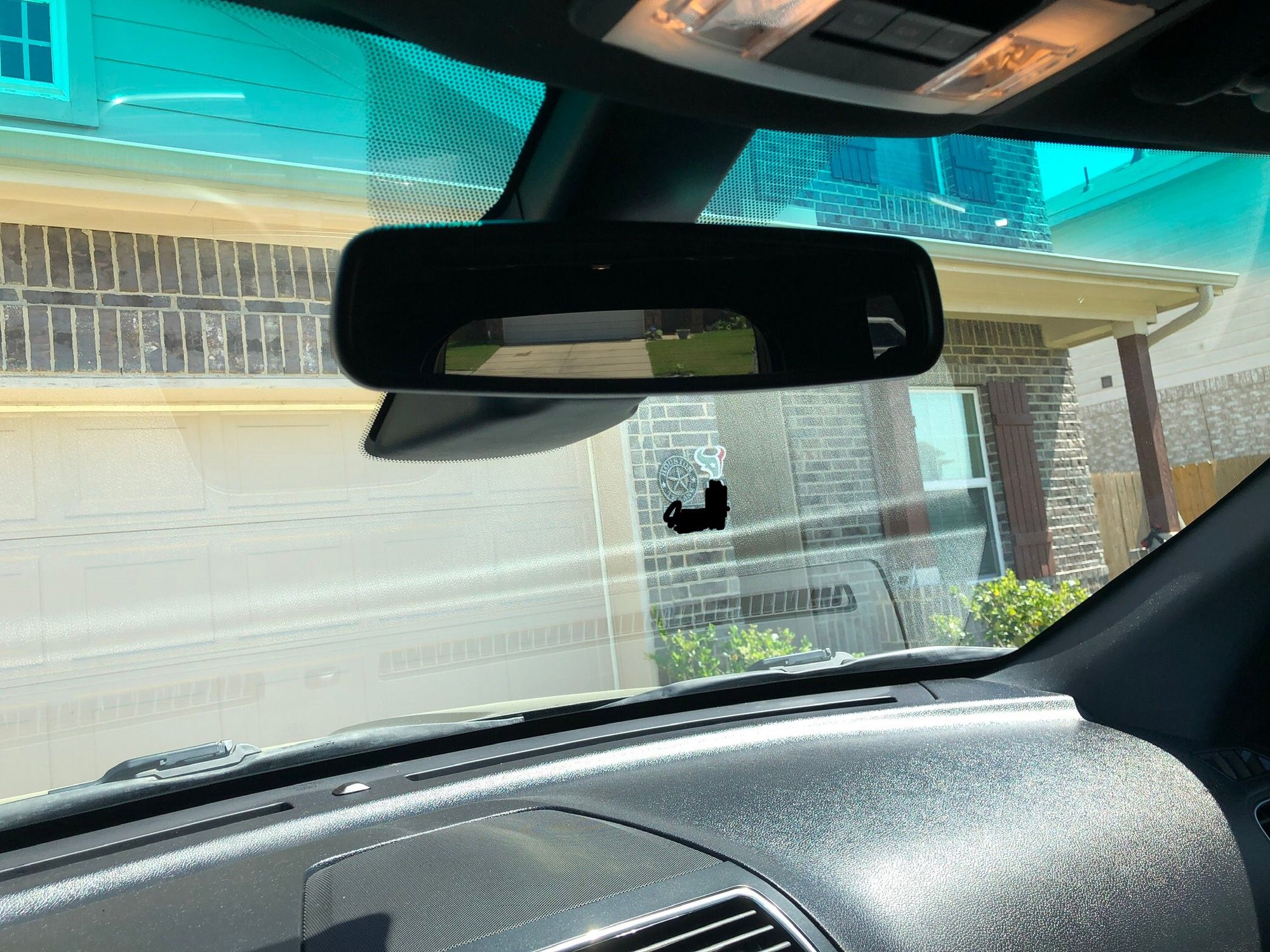

My truck is teasing you in the background over to the right
Don’t mind the part that’s scratched out it has my address on it that’s why.. other than that I liked the quality of work. They came to my house and installed it

Well it didn’t take my real reply lol those were the pictures I got it done from Last Chance Glass +1 (281) 781-9966 you can call or text him that’s his personal number he usually is the one taking care of big star ford down in manvel(Pearland) I like the quality of the work that’s just my personal preference.. keep in mind the price I was quoted was for an explorer not for an f250
