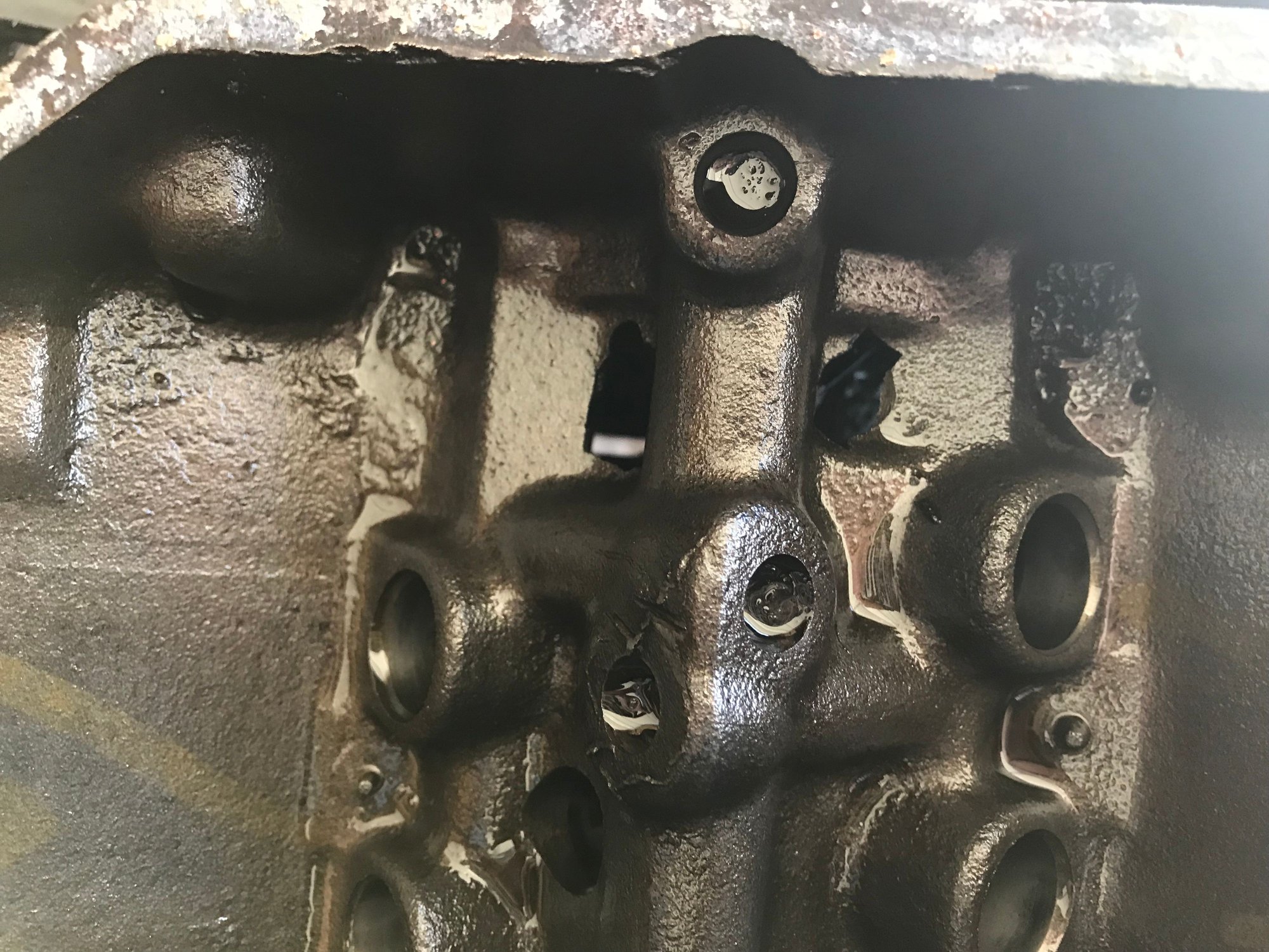

I also noticed it looks like part of the casting Brock in the top of the picture. Any one else seen this? That mean the block is trashed?

Ok did you happen to see the above picture looking what I would call the valley. There is a couple holes that look like they may have chipped?

I'm on a smartphone, it's tough to see. You'll have to use your judgment though, maybe see what a machinist sez.

Honing isn’t going to take those lines out. If you scrape the carbon away at the top you’ll most likely feel a ridge the way they look. I’ve seen valleys look like that doesn’t hurt anything.
I was told it was just poor casting. Shouldn't hurt anything a lot of valleys look like that. But of course I'm a stranger on the internet who heard it from a guy that works on dentsides.... take it with a grain of salt lol YMMV
