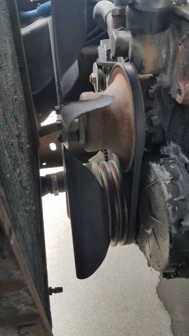

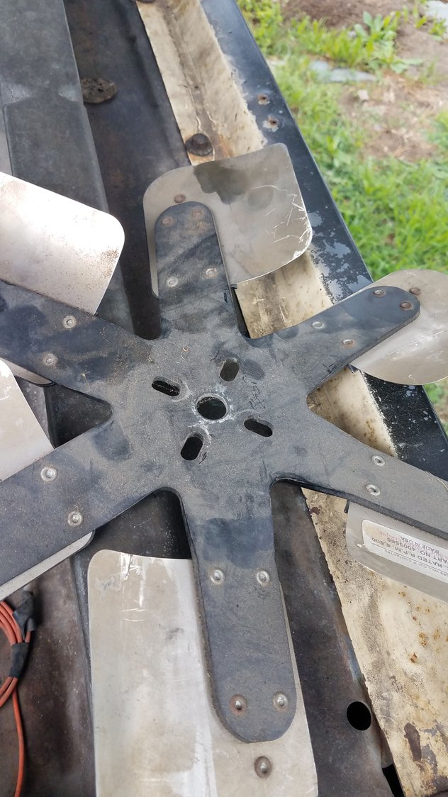

Radiator isnt pluged it flows free thermostat is as low as stant makes 165 i believe so aluminum radiator is next on the list but $$ isnt in the budget so right now i have a few options
Current fan
Other fan
Possible idea

If you are missing a fan shroud this will make the fan work WAY less effectively, so that would be the first thing, fabricate up a shroud out of cardboard maybe or something.

All three of those fans are completely wrong. Don't use any type of flexible fan. You need a radiator shroud and the correct fan, you can also use a fan off a 360/390.
