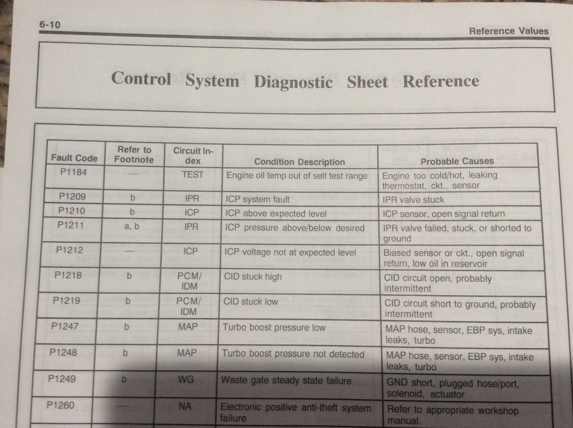

1247 is low turbo boost
1316 is a IDM fault, which is Injector Drive Module
if it were mine I would fix the P1247 first, reset the DTC and see if the P1316 shows up again and if it does do you get any other codes which should give you a clue as to the cause of the P1316.
The likely and easy cause of the p1247 is leaking CAC boots, turbo boots or the EBP tube needs cleaning.
from the ford factory manual. P1217 likely causes and then FJ9 is the pin point test for P1316
