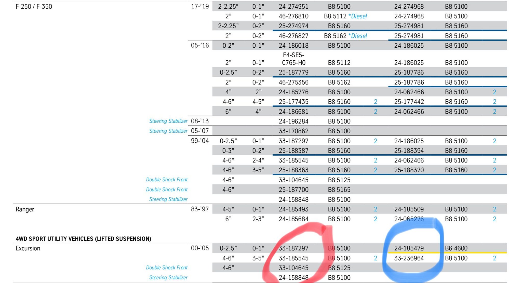

Very noticeable , The shocks valving is what gives a vehicle its ride and handling characteristics , Generally a pickup is going to be setup for handling a large payload securely with less regard or emphasis on passenger comfort.
If you want Bilsteins Excursion valving here are the part numbers.
red is from and blue rear, I don’t know you’re rear lift height so here are the numbers for both a 2” and 4” lift
