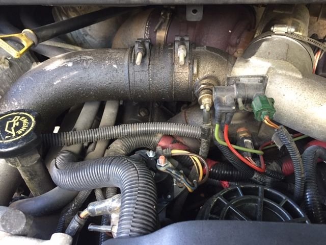

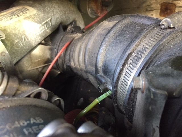

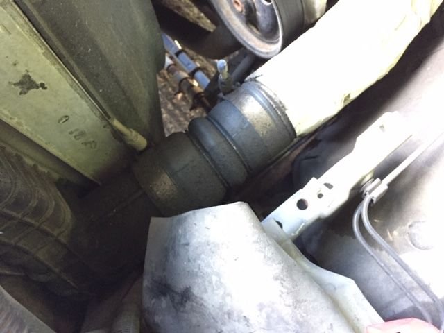

Ok, so today I finally started the some maintenance on my truck...
Please check the pictures so you will have a better idea.
Basically, I removed all the air intake (installed an AIS kit today), both intercooler pipes and all rubber boots and cleaned all up.
Same for the mist around the the spider and the turbo. My plan is to drive for a couple of weeks to check where the main leak is coming from.... my bet is on the turbo pedestal... the valley is oily too, but not wet, mainly at the rear.
Looking at the pictures, what do you guys think?

The turbo wheel looks pretty good to me, clean, moves freely, shaft has no play... thoughts on the oil mist on the outside? the other side of the turbo is bone dry...

- The turbo wheel looks good, a lot like mine did after 212,000 miles when I bought the truck. The condition of that wheel is a good indication of how the truck was taken care of and easily checked.
- Good call on replacing the boots, the OEM boots were OK, but the RiffRaff (or other aftermarket) boots are much better. Be sure to use brake cleaner on the mating surfaces of both the piping and the boots before installing them.
- The plenum inserts is another good call on your part!
- As for the oil mist on everything, that is what a 7.3 diesel looks like most of the time. The oil comes out of the CCV and permeates through the boots and joints in just about every system it touches. I would not worry too much about the mist looking oil, just clean it up and keep an eye on it. Your new RiffRaff boots will help a lot with that problem.
- The valley and pedestal look pretty good from the pictures. Again, this is what a typical 7.3 engine bay would look like. Clean everything up as best you can so that in the event there is a leak in the future, you will be able to pinpoint it easily.
- Your green line is popped out of the intake tube, not sure if this was intentional before taking the pictures or not.
- Soak the hard to reach and known bad spots with some sort of penetrating fluid.
Keep us updated with how things go and have fun!

Yes green line was disconnect just before the pics, tks. I'll get online and order the parts now.
