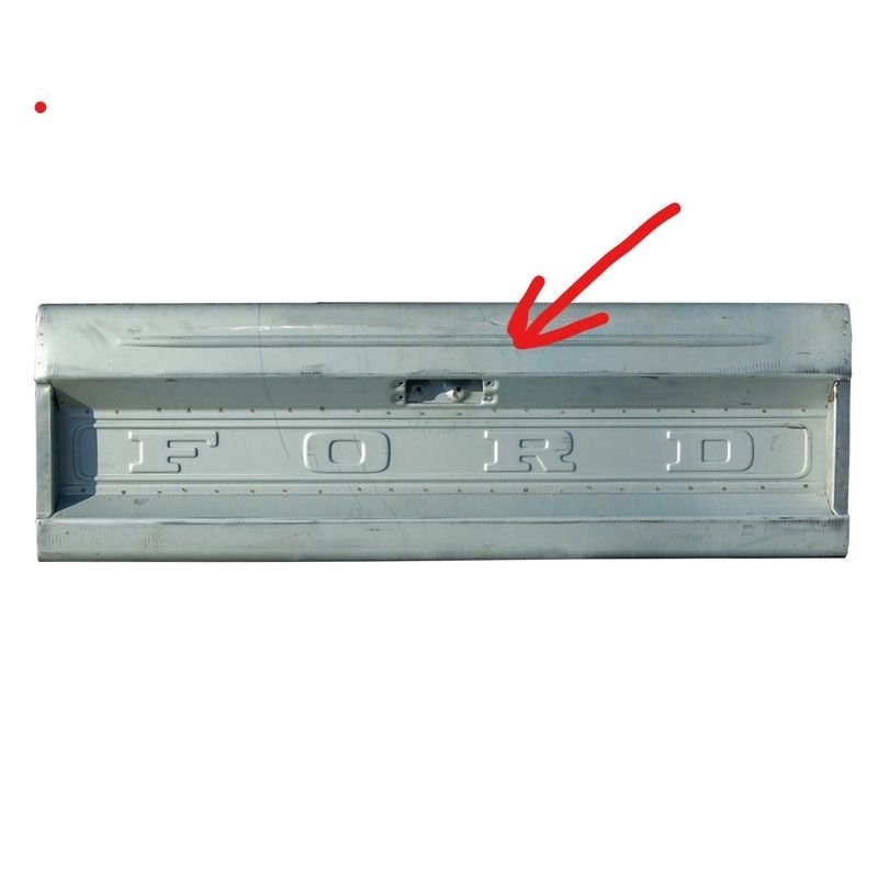

Is it correct that the horizontal detail above the handle (red arrow in photo below) is indicative of the 67-72 tailgate, but not found on the 64-66 tailgate?
Thanks for the input!
Raised ovate scallop line that surrounds FORD letters is visible on backside of tailgate, so it's not necessary to remove the finish panel.

[QUOTE=NumberDummy;18572573]Raised ovate scallop line that surrounds FORD letters is visible on backside of tailgate, so it's not necessary to remove the finish panel.
Thanks Bill !
The backside of the tailgates look exactly the same (except for the screws on the black tailgate holding on the ranger panel) FORD letters measure the same size and are same "font" on backside of both and their is no "raised scallop line" visible on backside. So both are the 64-66 tailgate. Maybe I will see if anyone on the 67-72 forum restoring a 70-72 Ranger needs that bling panel.

Pic of 1967/72 tailgate in post #5. Raised ovate scallop line surrounding the FORD letters. This is stamped on the 'gate, so it's visible on the back side.
1964/66 'gate has large FORD block letters. 1967/72 'gate FORD letters are smaller and the F - R & D have fonts on them.
