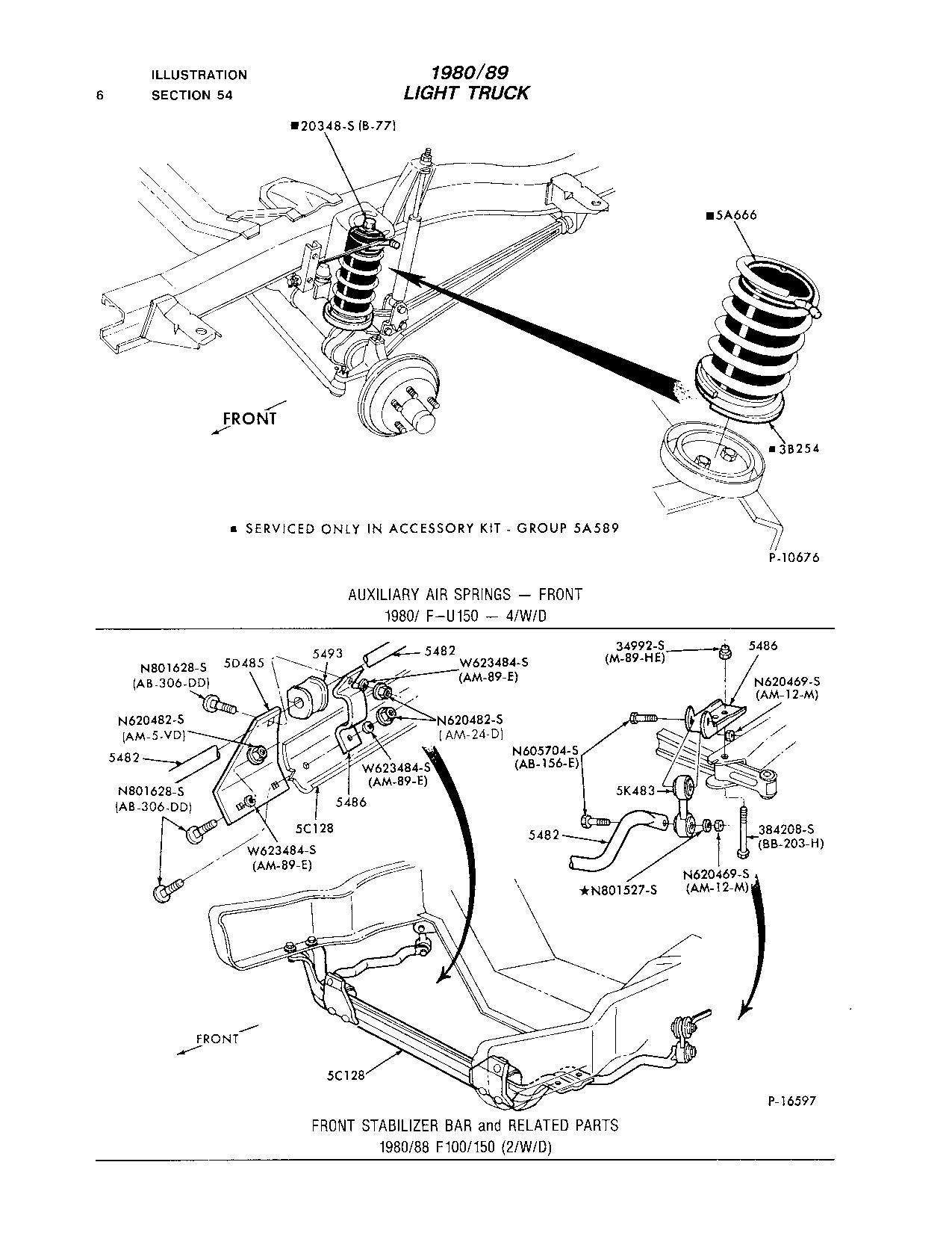

I want to install a front sway bar on my 1980 F100. Did the F100 come with a sway bar? I have a 1986 F150 4X4 it has a sway bar and four shocks. Was this typical of a 4X4 to have sway bar and four shocks?
Will the 4X4 sway bar work and what do I need to pull it off? the pivot at the base of the coil spring looks like the issue.

Originally Posted by sdelivery
I want to install a front sway bar on my 1980 F100. Did the F100 come with a sway bar? see lower pic:
F150 4WD is not a good comparison since F100's were not available with 4WD after 1976.

Thank You Guys, I should have stated the F100 was 2wd just to be clearer. I am hoping that the 4X4 components will work. There is a bracket under the coil spring seat that the sway bar attaches to. I didn't see it on the previous drawings.
