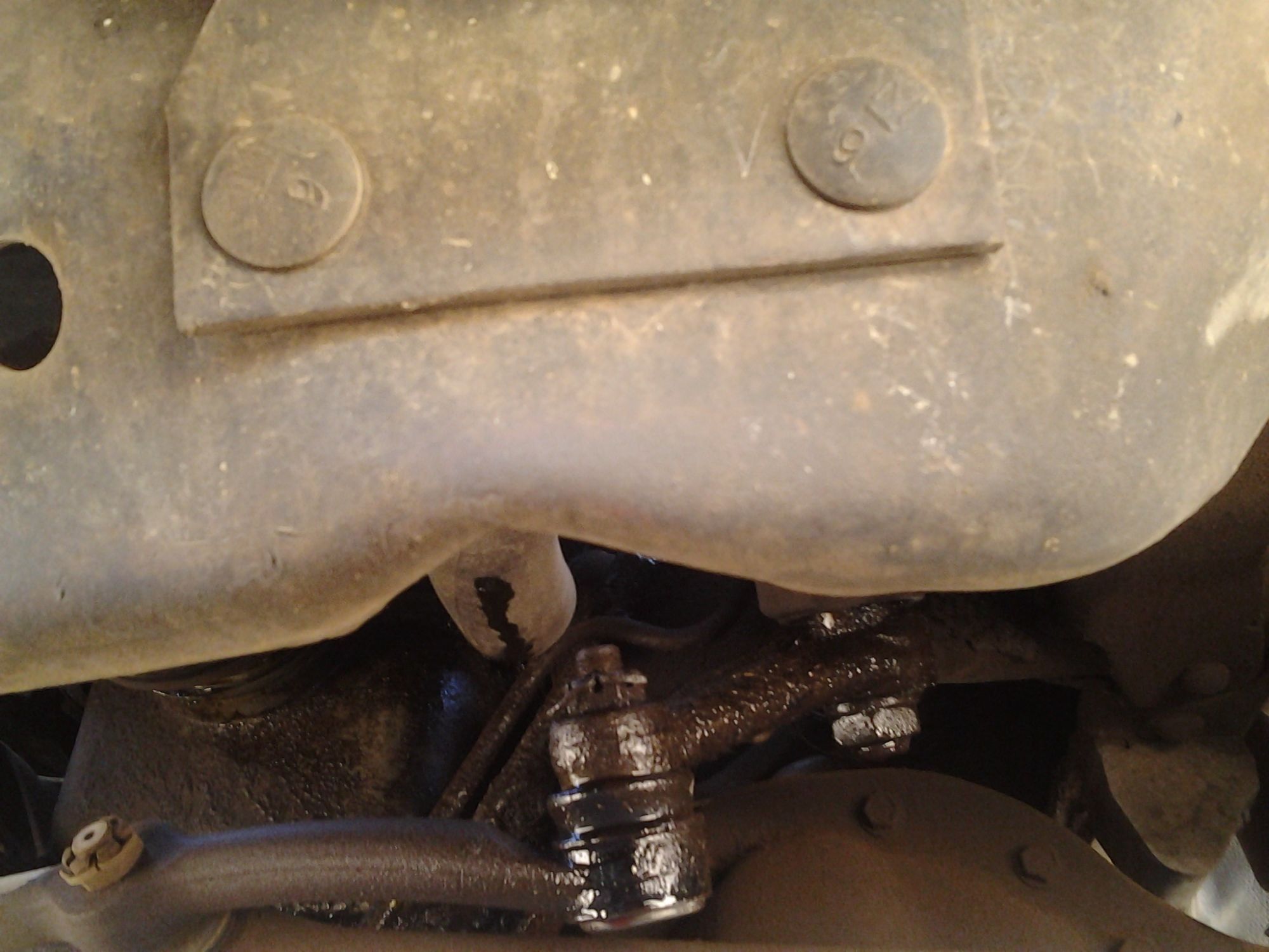

Alright well I have bad news. The crossmember that my sway bar hooks up to is bent and was making the dog bone lookin thing rub against my shock and punctured it. Anyways. No one has the crossmember and all the trucks I found have sway bars that connect to the frame. So I was wondering how expensive it is to do coil over shocks or if I can just remove the front sway bar for good......any advise. Im pissed that I have to replace the shocks. So if I can remove the sway bar without causing problems would be a god send.

dont worry about the leak but the top of the picture shows where the crossmember is fubar.

Unless you like driving your truck on it's roof DO NOT remove the front sway bar and leave the rear one installed! You could get away with a front only sway bar but not a rear only, so my suggestion would be to clearance that bent up cross member for the swaybar if you can't straighten it enough to clear the bar.

as ive said before it was like this when i bought it as i havent driven offroad or anything. now the only problem that im having is that the sway bar was right next to my shock absorber and punctured it. i dont have any way to replace or fix it but if i cant remove it or both the front and rear i will have to figure something else out
