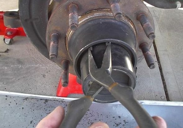

If the inner axles or driveshaft are not turning then the auto hubs are not locked, if one of them is stuck in the locked position then you can just remove the entire hub without tools although a pair of pliers makes it a bit easier.
squeeze the spring clip and pull it out, then remove the hub

You can do this with the wheel on too. Ford considers them non-serviceable but I cleaned them at least once a year with this procedure and never had an issue with them: Welcome to guzzle's 4x4 Autolock Hub Lubrication Maintenance Web Page
