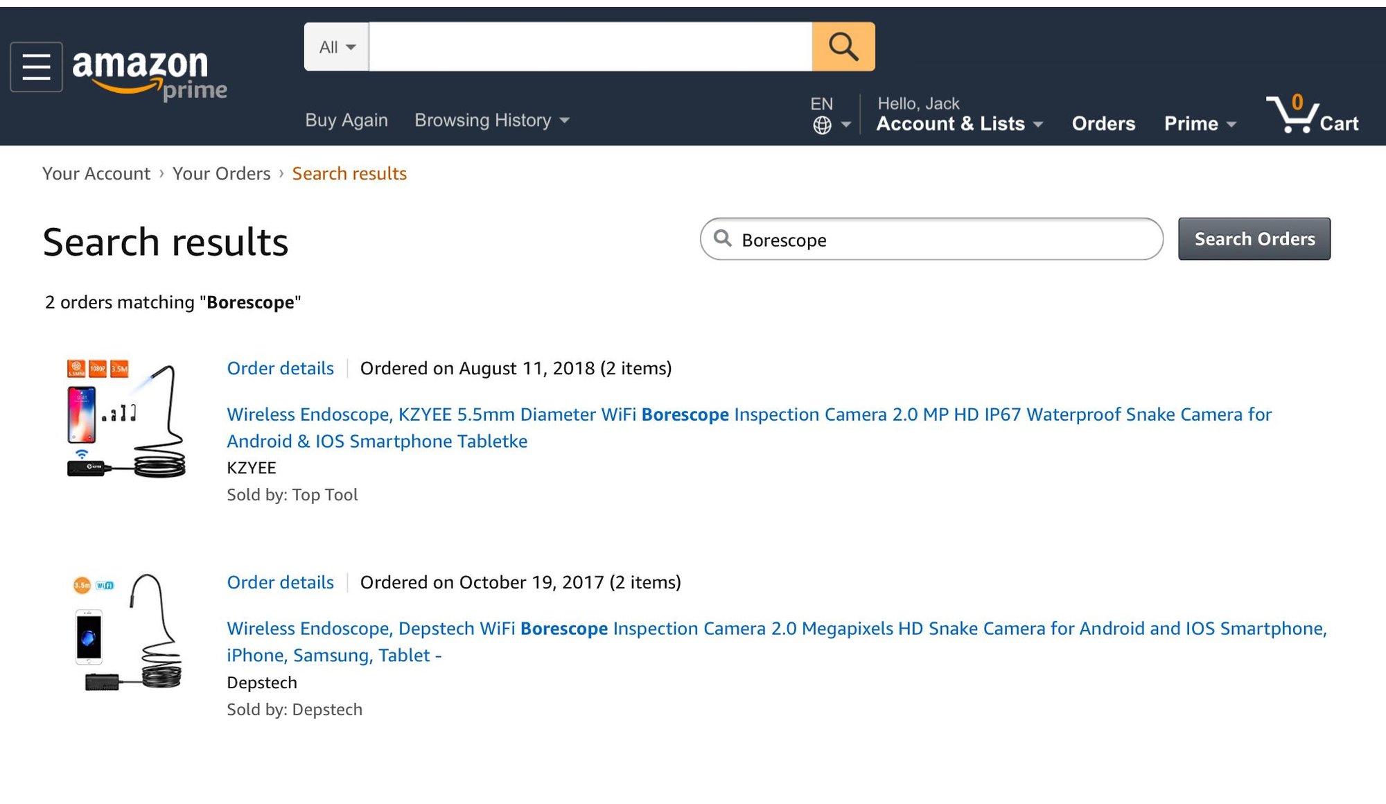

Horoscopes to know how the day is going to go with the motor or borescope?
Another member here turned me onto these. These are the two I’ve bought. The top one is smaller in diameter so that it will fit into the glow plug and injector holes so the pistons can be inspected to confirm a major failure, like I had long ago. It’s not sold right now, but they all are similar. I’ve already used them for other things, as simple as check for things lost under the ref, confirming in-wall issues that were flakey with a wall scanner, and checking out brakes on my 1952 dozer. For the price it’s a great tool. I’ve recorded and inspection of my motors cooling jackets and found two casting bridges which would have released sand into the cooling system.
The coloration is shifted blue due to LEDs, but it’s fine. Does the job.
