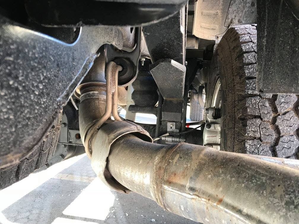

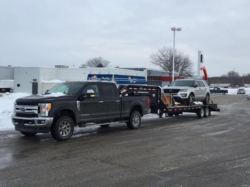

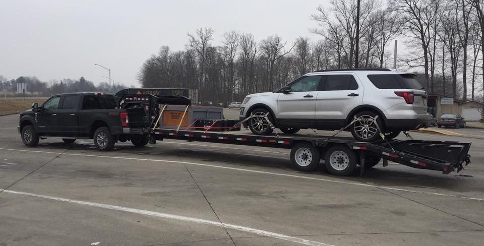

I put the SES on and when unloaded I have not been able to tell any real difference. I had airbags on my previous ram 3500 and removed them when I had moved to WI. While there I moved to my current truck and added the SES before moving. The pics show the space as unloaded and then when loaded. I pull a 28ft PJ when we move loaded with the wife’s suv and some basic stuff to cover us until the house hold goods arrive. I suppose they are the regular size as I just ordered them from a website. Anyways hope this helps.
Did you have timbrens fr350SDJ?
Also can you measure your rubber bumper for me pls

I am not able to get the measurements right now from my truck, but I did confirm from my receipt the other info.
I purchased them from etrailer and the part/ model number from it shows TFR350SDJ.
According to their questions and answers portion for this part, one of their replies mentioned measurements of 8 1/2 in wide and 10 1/2 in tall by 6 in diameter. This response was addressing a question about a 17 F350 as the rear sits higher the owner was wanting to know if spacers were required.

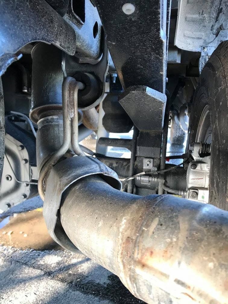

I installed a set of Timbren’s on my F550 today. It would squat quite a bit while towing before. Now it sits on the Timbren’s all the time empty or loaded. I get less bounce when empty now and it hardly settles at all when I load it. I’m pleased with them.
Mind you, this is a wrecker, so when I am towing the weight is being picked about 4-6’ behind the rear axle.
I attached a photo comparing it to the factory bump stop.
