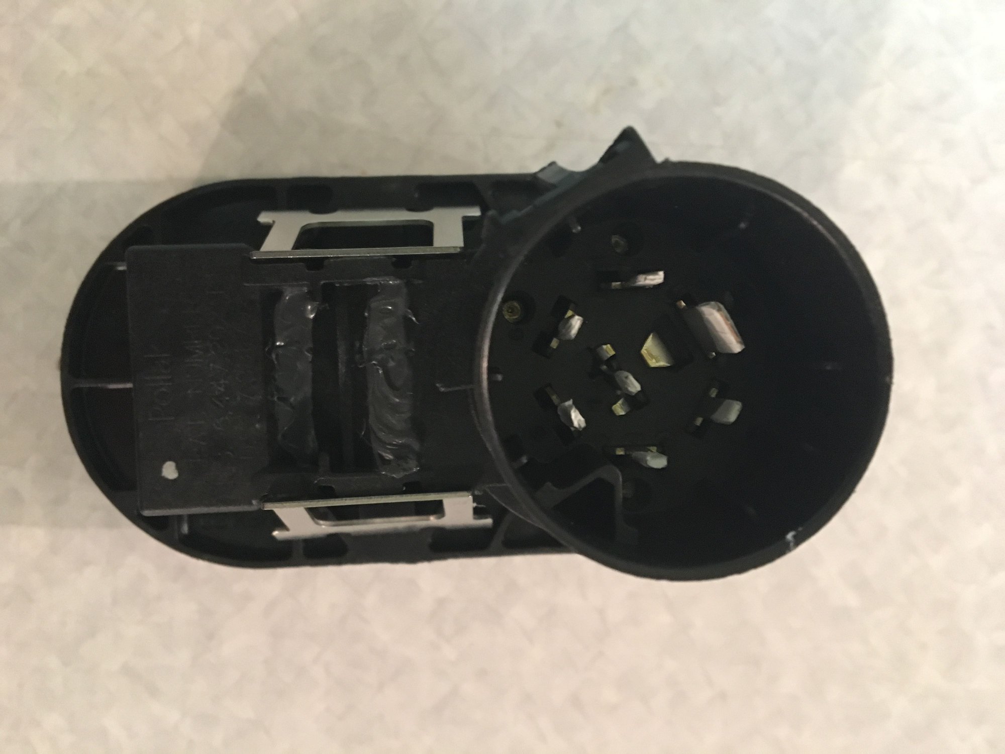

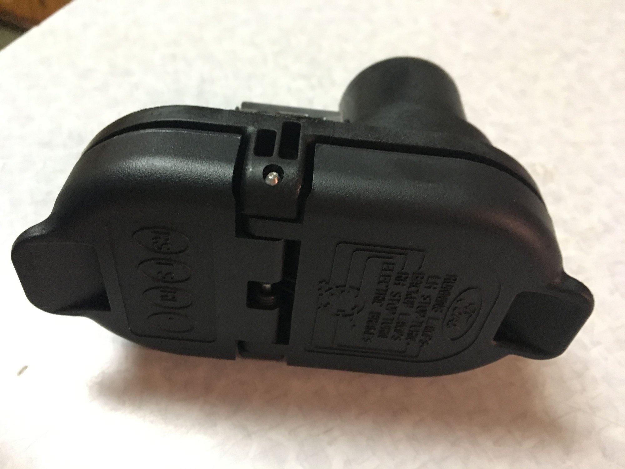

It’s water in your 7pin trailer wire harness. You can’t just blow it out. Water got in where the wire harness connects to the 7pin. You have to drop the spare tire, unplug the harness, remove the 7pin plug and exchange it at the dealer. When they give you a new one, they will expect the old one back. When you install the new one, use a lot of dielectric grease. You will see that Ford used little to no dielectric grease on that adapter and that causes the fault. When you are under your truck pulling the adapter out, it’s a good idea to add dielectric grease to the other 2 or more harnesses near the spare tire. I’ve posted numerous topics on this. There was a service advisory as well. You’re welcome. See photos of what you need
Makes sense to me. Luckily, I haven’t experienced it again (and did a long pull yesterday) but I’m sure it’s only a matter of time. Thanks for the info!
