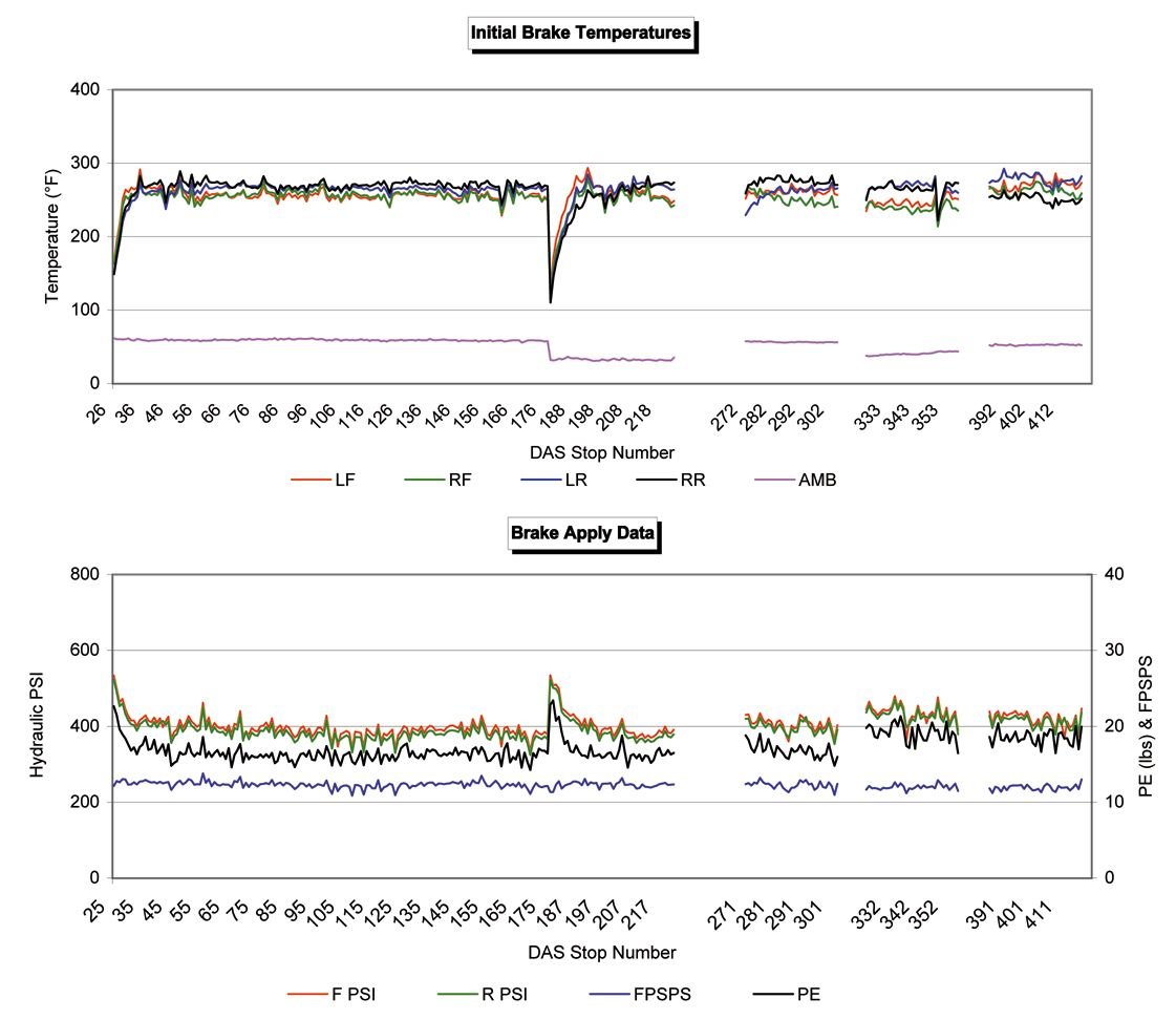

Hunting around on this computer I did find a graph from an Excursion. Loaded to 8,800? GVW, these are burnish stops, 40 to 0mph, every 1 mile at moderate deceleration. If you look carefully at the initiall 200 stop burnish to bed the brakes in, most of the time the rear brakes are running just slightly hotter then the front brakes. More at the last 10 applications. Then also look at the second reburnish, the third section of data. Again, one stop per mile is a lot of brake applications and at that speed and weight, a lot of energy dissipation. CONSISTENTLY!!! So there is a lot of heat soak to the components, not like what you would see in commuter driving.
So a way long way of saying the best thing a person can do is learn how their truck reads over time, maybe shoot the rotors (in the middle of the scrub width) every so ofter after the drive home from work. That way you establish your normal thermal pattern front to rear and side to side, and your'll have the baseline to know when things are going downhill.
