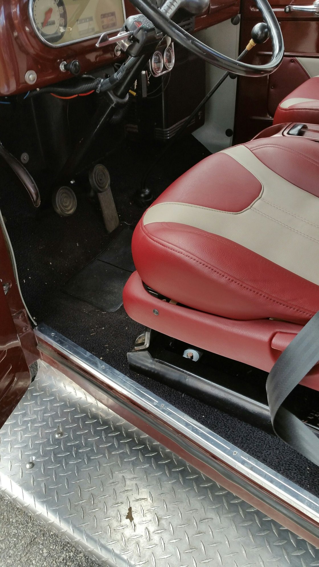

This is good info, I'd love to see some pics of how you guys finished off your floors, especially near the door edges. Having a 49, I can see creating something like a door sill will probably be necessary.

I finished mine with a readily available door sill. I believe it was for a 53/56 F-100
