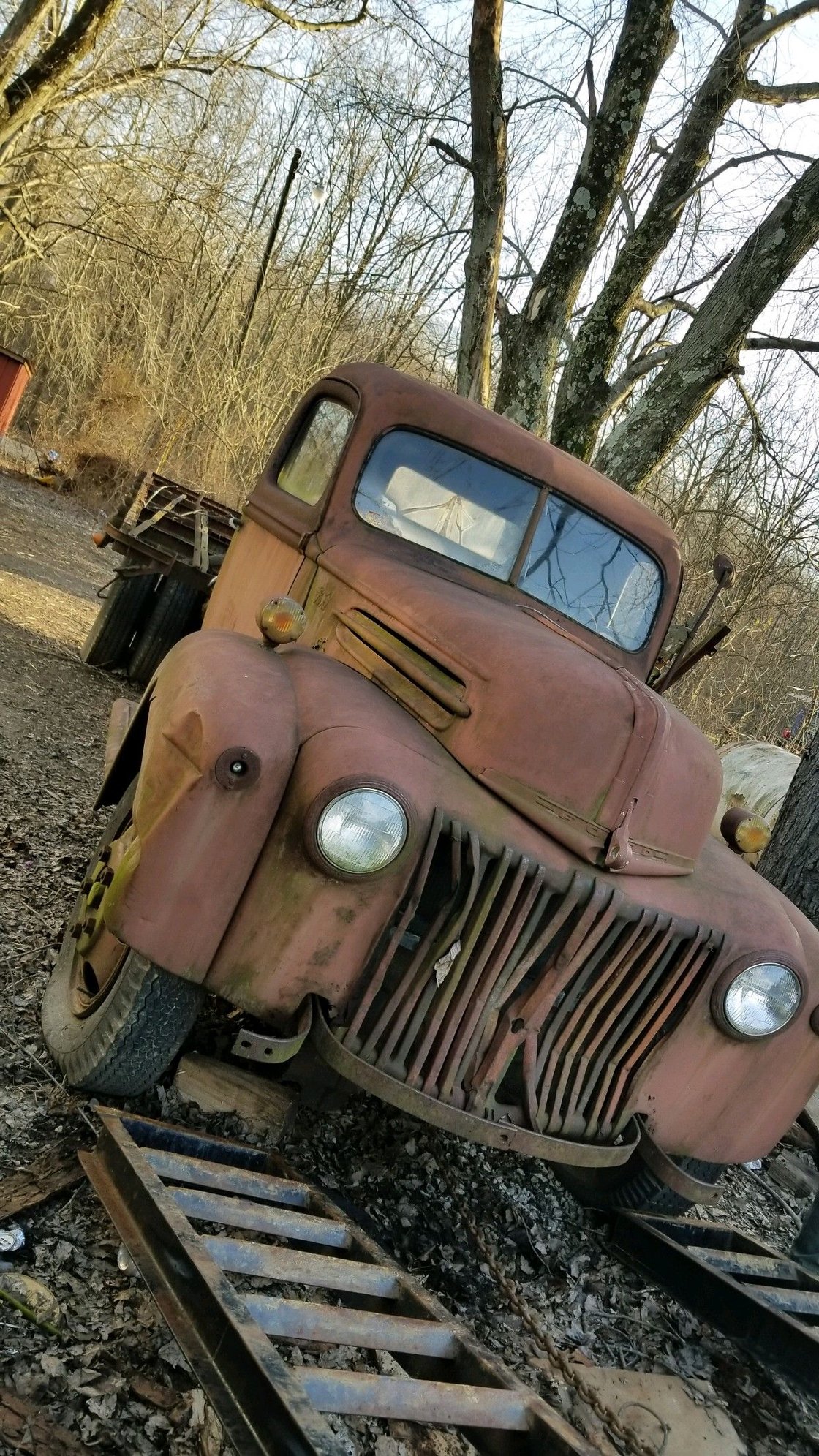

Hey all! I just recently picked up a 1947 1.5 ton grain truck, it has some cancer and what not, and a locked up flathead V8. My biggest question at the moment is the wheels, i want to know how safe they are to change myself? Or if there is a one piece after market look alike. I really like this truck and have wanted one for awhile and Im looking to rebuild it in the foregoing years!
i actually have the original title from 1947 for it too!
