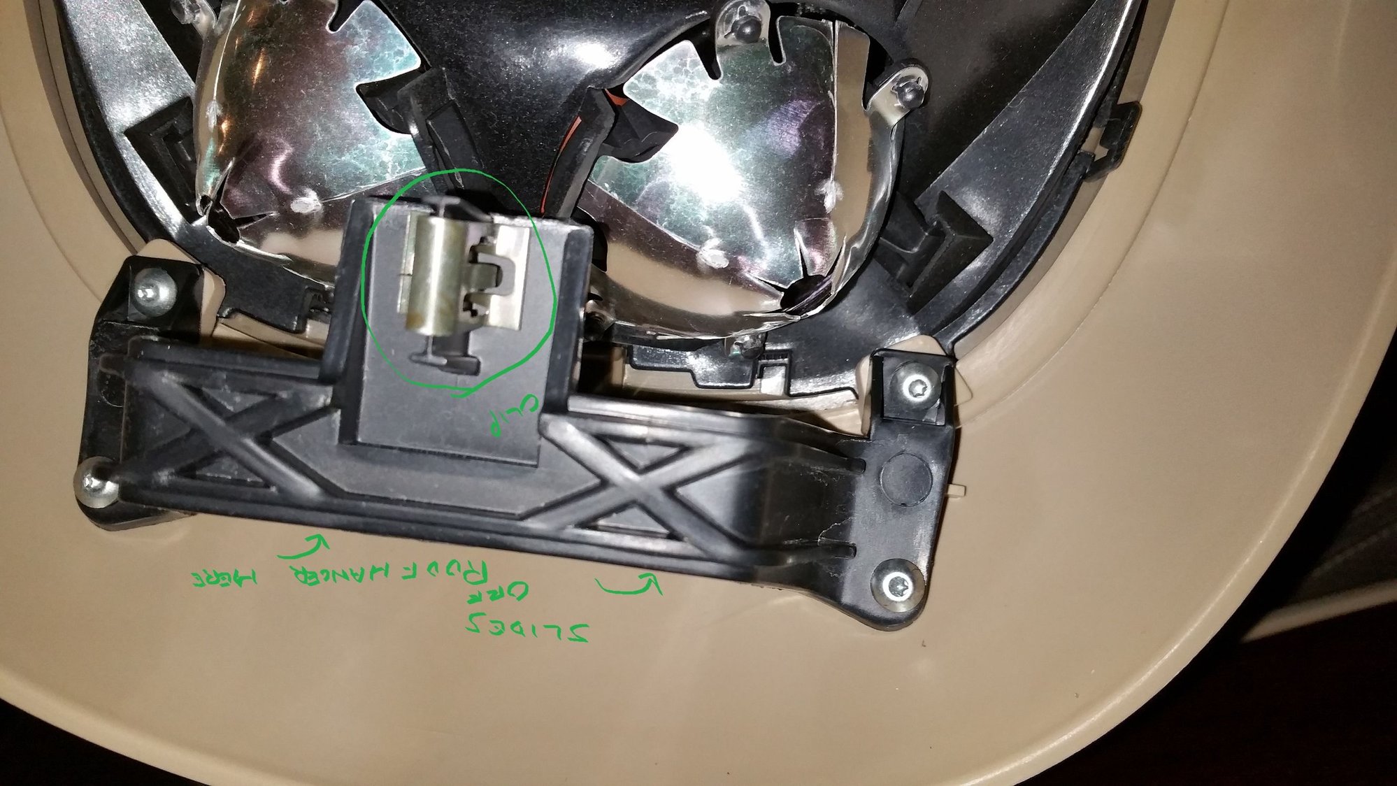

Pull down from the FRONT first. NOT the back.

^^^ Mike is correct of course ^^^
Pull from the very front of the console near the window (straight down) and the front clips will disengage, the back has a hanger bar that holds it up to make it easier to install/un-install (for one person). To get it off the rear hanger bar just lift the back end up and move it forward, then down it comes.
