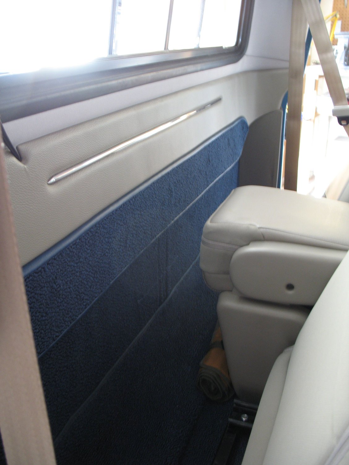

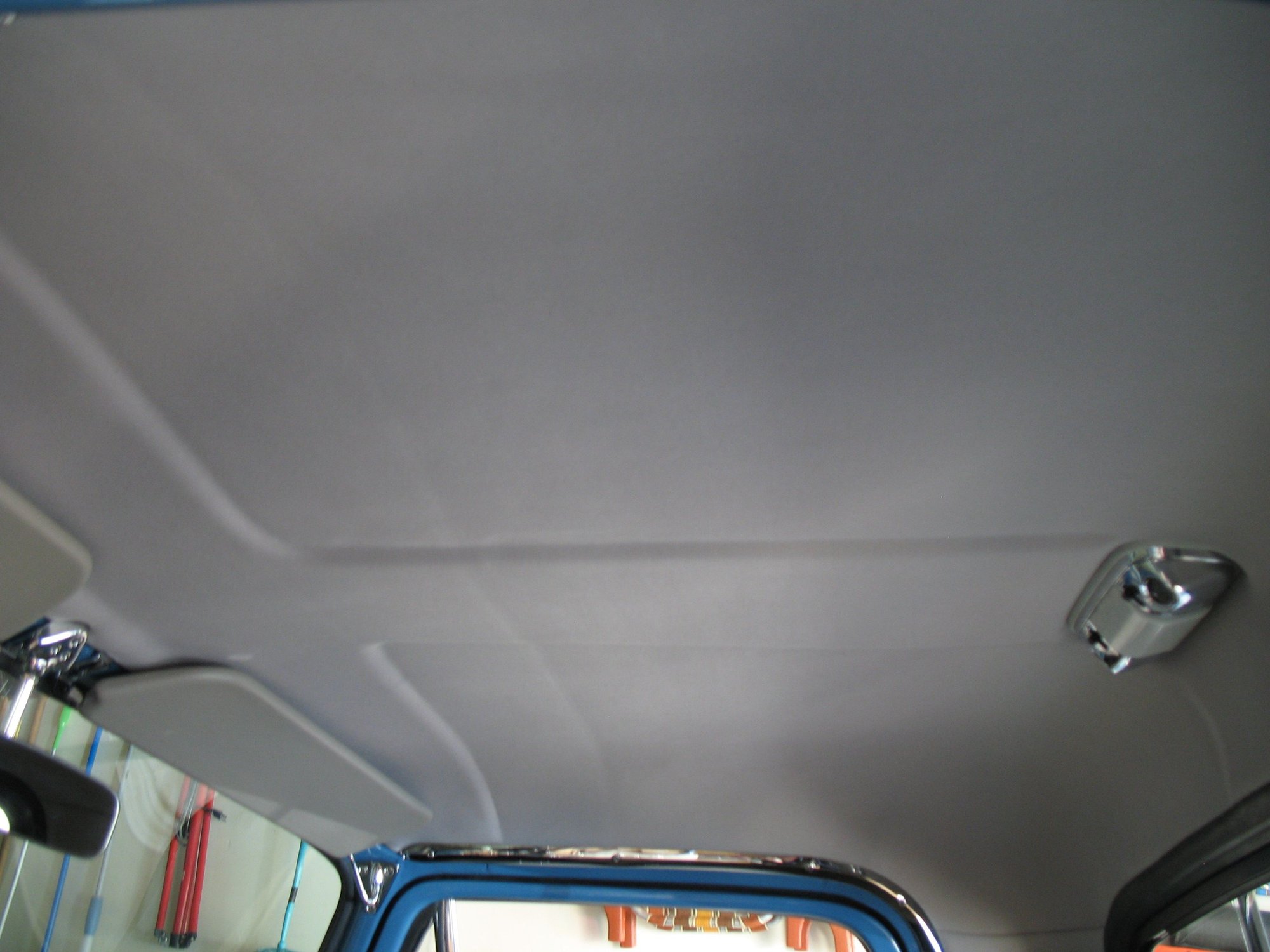

Have here photos of the armrests in the position I chose. Yeah, I went off track from the original post and added views of the finished interior....will post these to my build thread as well. The headliner is molded ABS from Hot Rod Doors, and it fit very well. I like the contoured fit!

That's an awesome looking interior. Very modern look. Great job

Wow!! That looks great!!
