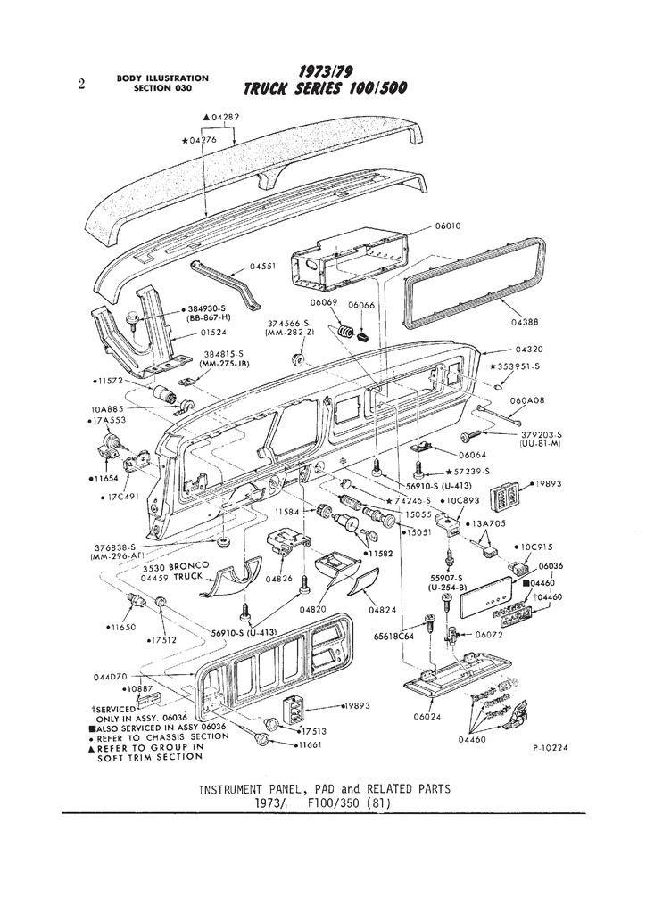

To get a walk thru on how to remove the headlight switch stud and **** to get the dash bezel off to get to the switch go here. And welcome to FTE. You do not have to remove your instrument cluster just the bash bezel.
https://www.ford-trucks.com/forums/showpost.php?p=14880899&postcount=66
And https://www.ford-trucks.com/forums/showpost.php?p=14982704&postcount=78
