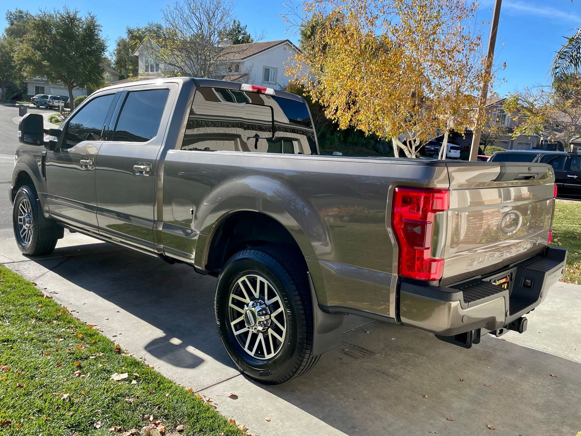

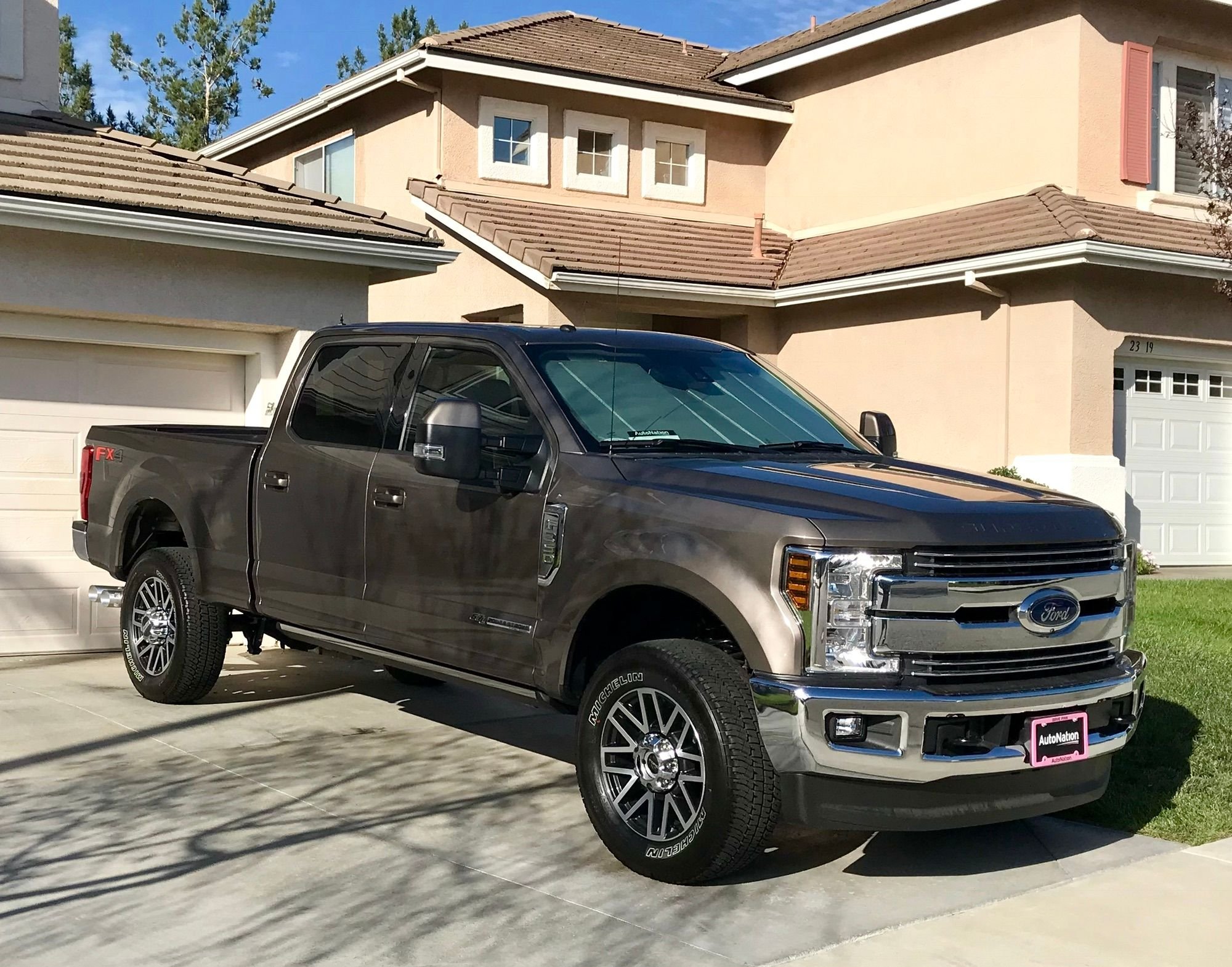

My ‘18 F350 was a Lariat with chrome. It’s not too far from you, take a trip to Santa Clarita (no. LA county), this guy is the best. Full disclosure, I do not work for or have an interest in this company, but Chris the owner, one11ink.com took great care of me, and the work has lasted 4 years and still looked good when I traded up for a ‘22 F350 Lariat sport package.
If you notice Chris even did the ford logos and the fender badges
pm me if you need more info.
