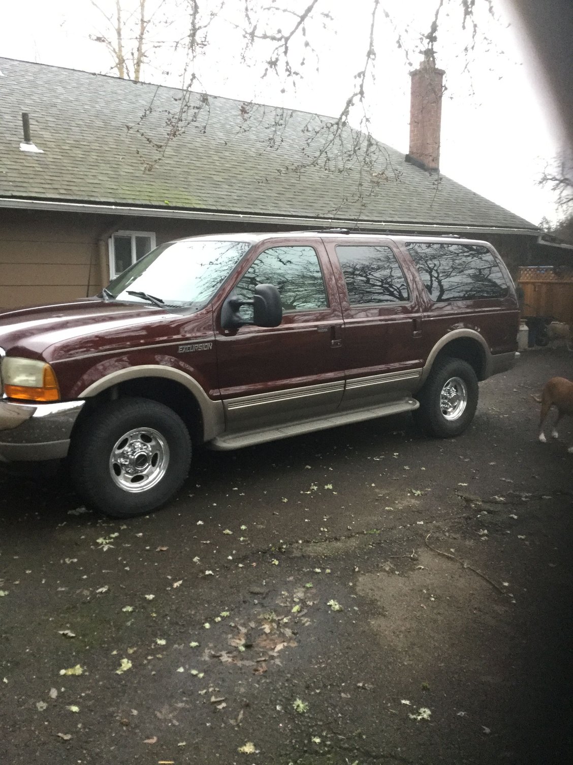

Just picked this up today. 2000 Excursion Limited, V10, 83k miles. I have done some research on the axle ratio, it seems that it's not stamped on the door jam sticker for this modle year. I do have diff tag code of PM 421 D if anyone has any insight on the ratio? Any recommendation of things I should inspect immediately?

Most EXs from '00 lack the ratio on the door jamb stickers, give those axles another look over to see if there is another tag or more info on the one you saw. Another way to determine if its the more common 3.73 or the optional 4.30 gears is to check the RPMs at 60 MPH. Of course this will work best with stock sized 265/75R16 rubber but the 4.30 gears will have it turning about 2200 RPM at 65 MPH, 3.73 will be just under 2000 RPMs if I recall correctly.
What are your plans for it?
You may want to remove those roof crossbars as they are next to worthless due to how low they are and they can rub the paint off the roof under them, most of us go without them for those reasons.

Thanks for info Sam I Am and WE3ZS. Plugs and coils we're recently done but I think I will do the plugs again just to insure they are the correct brand and torqued appropriately. I need to reaserch torque specs on the plugs so any info on that is welcome. My plans for this vehicle are to use it for road trips with the family and to tow my camping trailer. My immediate plans are new plugs and removing the roof crossbars .
