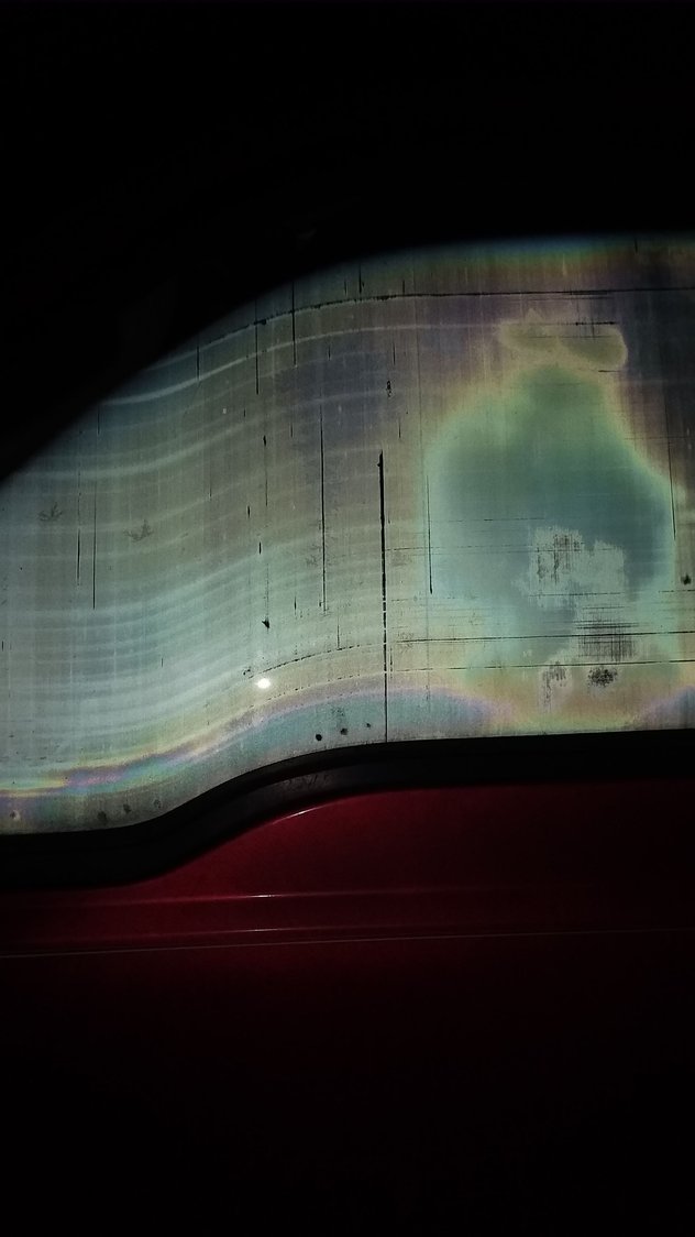

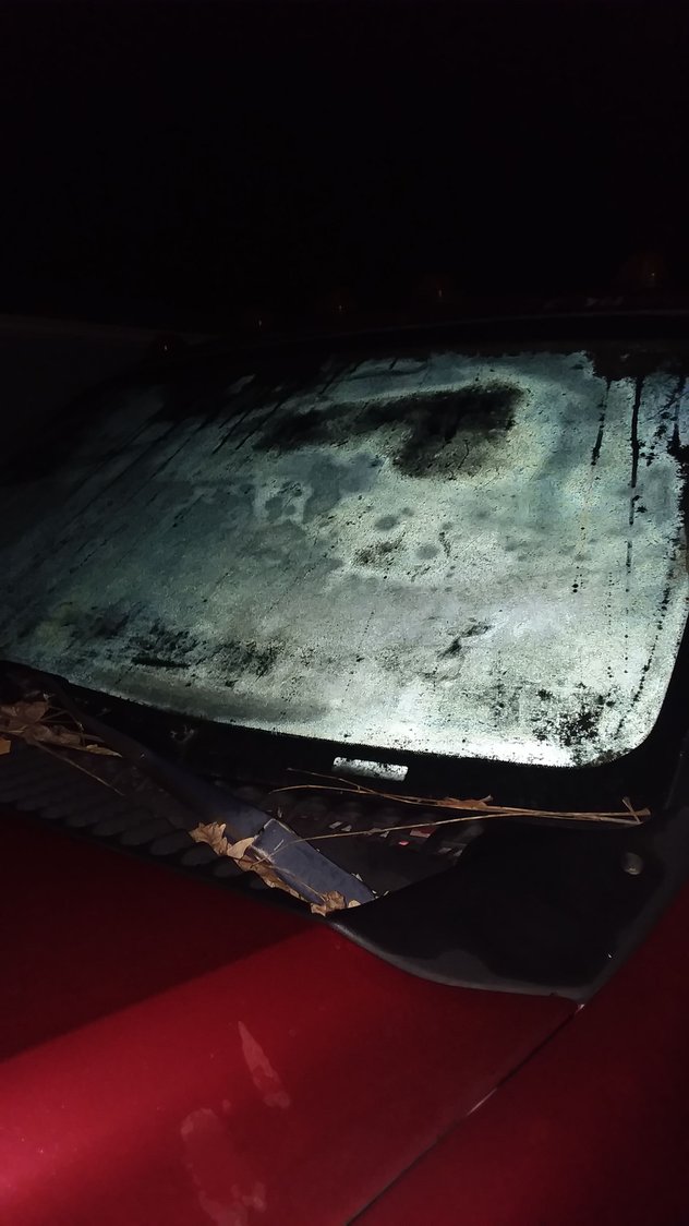

03 f350. Just wondering if anyone could tell me why all of my windows are frosting over on the inside? I haven't driven or started the truck on a couple of weeks. Tonight it's about 45 outside so no frost but the windows are all frosted over inside.

That's because you obviously have water in the cab causing moisture buildup. The windshield is a prime suspect as they are known to leak.

I'd say definitely excess humidity in your cab either from wet boots or a leak. If you cant find the source right away, think about putting a container of DampRid or a small bucket of calcium chloride (ice melt) in the cab to absorb some of that moisture. It will help temporarily.

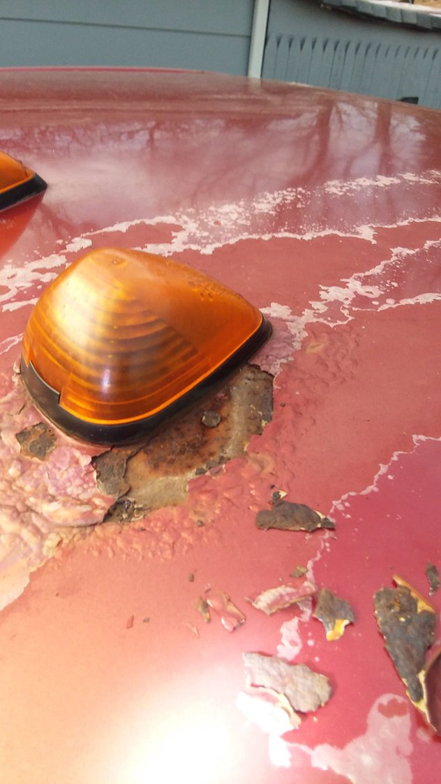

Thanks for the info. I noticed some paint flake on one of the cab marker lights , I'm going out in a few minutes to see if I have a rust hole around the lights.

I have taken a look under the dash and water is there all the way into the floor insulation. I believe it's coming in from around the cab light, it's pretty rusted around the front if it.

That is ugly. Were those factory or added later?

It's an 03 I bought it 3 years ago so I dont know if they're stick or not.

I wouldn’t discount some water getting in there but sounds more like a windshield leak I wouldn’t be a bit surprised if you were getting water from both places. I had one truck with cab lights, never again. I didn’t have any leaking yet but there were starting to rust along with everywhere else good riddance to that rot box luckily I dump it before it got to bad.

when the weather gets warmer I'll check it with a hose. In the meantime, I can use some silicone around the lights and windshield. Springtime, I'll pull the cab lights sand down the roof line and run a TIG weld to seal up any holes. Probably won't put the lights back on.
