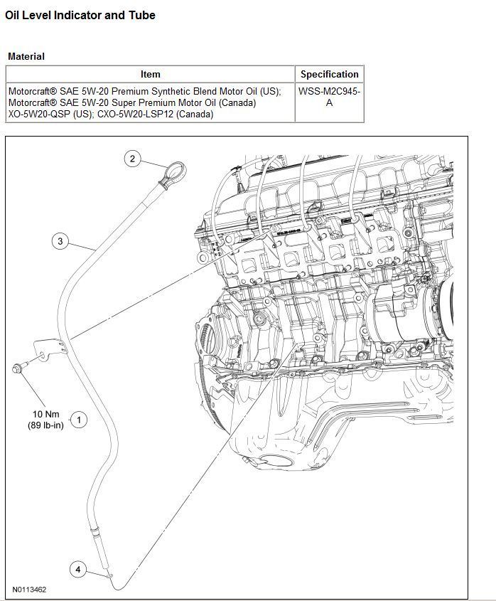

This is from the 2015 Ford Workshop DVD. Sounds like a major ordeal to replace it.

Thank you so much! After spending some time staring at it I figured removing the motor mount still wouldn’t give me the clearance I need. The issue with my manifolds is when the shop was doing the other side every bolt broke. I had the truck in there getting several things done and the broken dipstick tube was on the list. I wish he would have looked up the repair order before removing the old one. The broken one wasn’t leaking. I was already pushing $2k with the work that was done I wasn’t about to have them drill out 8 more bolts or however many there are when doing an additional manifold.
I ended up cutting the new dipstick tube about 3 inches high, threading it, and shoving a bolt in it. Should be a better plug than whatever was done before. I’m going to have the manifold replaced this coming summer when we get back to working again. This is definitely temporary but at least I can get the truck on the road here and there. I really hate half assing things!
