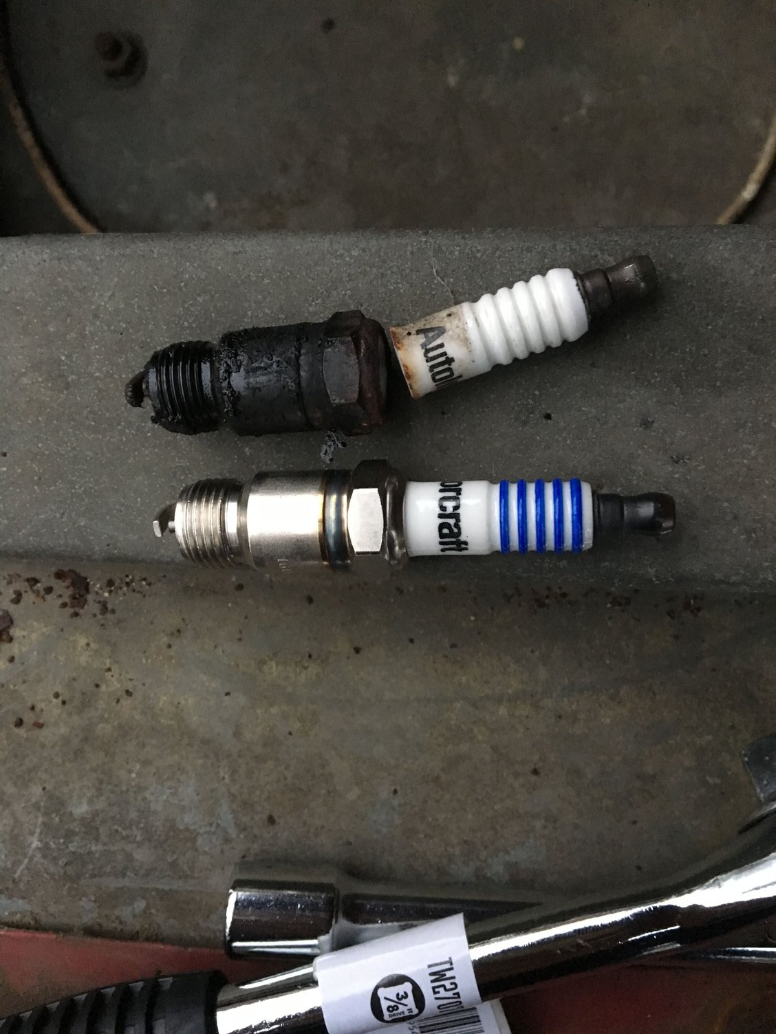

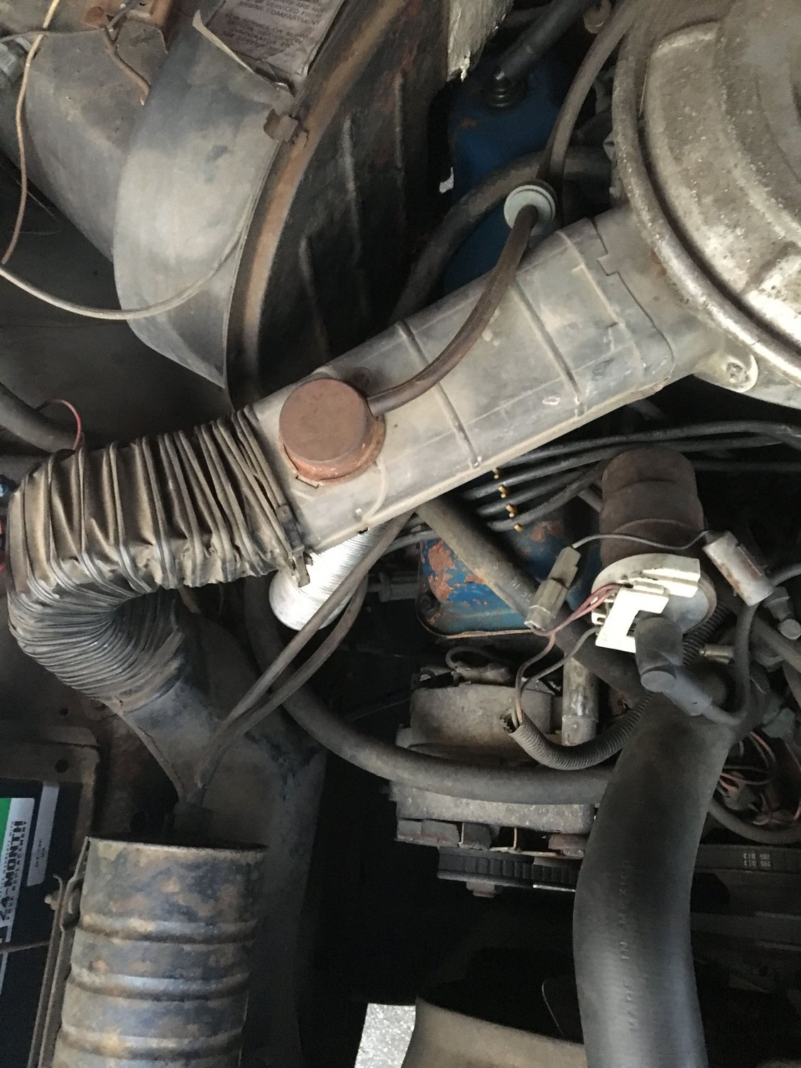

Today i started to replace the spark plugs and the dist cap + rotor. On the driver side i got all plugs out and one of the plugs was actually broken - so it was running on 7 cylinders .... On the passenger side there is sooo much less space to work and i am not sure whether i need to get the AC assembly out of the way first... cylinder 4 seems unreachable... see pictures. Do you think i need to take that unit off?

Man that is tight to be A 70’s model truck. Have you tried a spark plug socket with a universal joint? That may would help a little.

I agree with Mako, that is pretty tight for a 70's era truck. Take the air intake off and see if that give more room to work, and universal joints are your friend on this type of thing.

I approved your request to join the chapter and sent you a PM. Don't forget to sign the roster. With spark plugs I like to take my time. There is nothing like snapping one off, and turning a very simple and easy maintenance chore into a painful top end rebuild. Which engine is that. I'm thinking it's a 360 FE, but the shot wasn't really that good. Is that insulation on that spark plug wire damaged? And that coil looks like it's got some age to it as well. If i was doing a tune up, I'd probably go ahead and throw a set of motorcraft wires on as well as a coil. Did you pull the dizzy cap and see what the contacts are looking like under there? Even if you take a piece of sand paper and just score them up a little bit, it might help in getting a better spark.

i couldnt try again today to get that last plug out but did take the intake off. I do have new wires and distributor cap with rotor that I am replacing as well. The rotor and cap looked actually pretty good - they must have been replaced at least once...
That coil does look really old and I def should get a new one too!
Once I am done with the wires, I think the next job should be to check for vacuum leaks... The idle is pretty high and also the engine still runs pretty rough... (let’s see how it’ll be with new plugs etc...)
