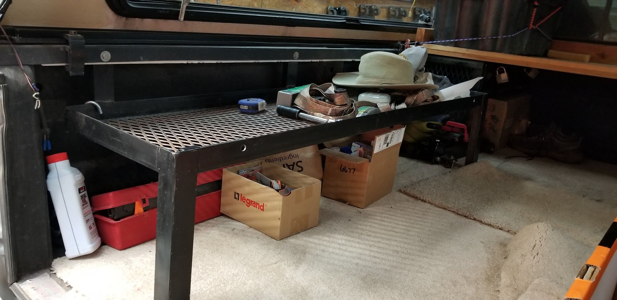

Since I have a steel shelf that I built which bolts to the side of the bed and runs over the wheel well and comes close to the tail gate and has legs that sit on the floor of the bed I just grab onto the back leg and pull myself up with that. I keep a piece of carpet to protect my knees on the tail gate. It's very easy and I am no spring chicken and my F350 is high in the back. If I ever decide to get a step though that folding one looks nice.

pic sir. Im a mechanicalism, but a pic will help with what ur describing

Pic as promised....I welded nuts onto the backside of the three pieces of channel that are bolted to the bed rail for easy installation then there are two legs on the front side with smooth plate on the bottom to rest on my carpet. It's full of junk right now but I use it for a big ice chest that I can access thru the side window that lifts up. I also keep a plastic bin next to the cooler with our dry food when camping or fishing in Mexico, it's handy to get to when you need a road snack too. It covers the wheel well making it possible to put things close to the side that the wheel well would otherwise prevent, plus I can stash a lot of stuff underneath. The angle iron sides do not allow the cooler to touch the side window plus bungees can be used in the drilled holes or anywhere in the expanded metal for rough road use.

That'll work Bigs.
Having a shell as well and primarily using the 02 as a wkend warrior, i rebuilt the bed with 2×4's. to crash on when wkend fishing. Metal getn WAY TO PROUD anymore. 50.00 for a 1.5x2.5x20ft stick of .063...its over the well as well so has enough of a catwalk. Got everything stuffed under but a metal folding table would do a job holding dinner, heater buddy..etc

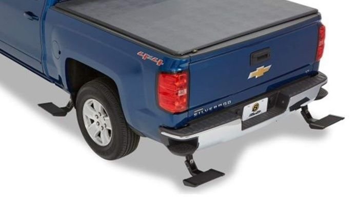

Looks like Bestop makes one which can be mounted to the side of the truck from the frame rail (in front of the rear tire, but different part number -- 7530315 is for the rear mount under the bumper, and either 7540315 or 7540415 for side mounting, depending on which side you prefer).​​​​​​

If I didn't have the wheel to wheel Iron Cross 3" running boards on the sides I would certainly entertain the idea of the side step. Since I do have the wheel to wheel running boards, I now have access to 100% of the bed from the ground and a safe way to get up and down onto and from the tailgate.
This is great information for those that see this thread in the future though Pete, thanks for sharing it with us.
