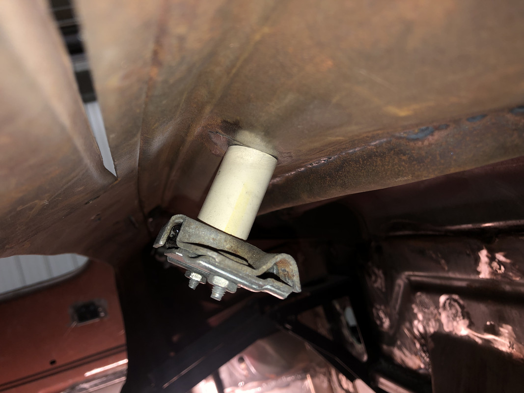

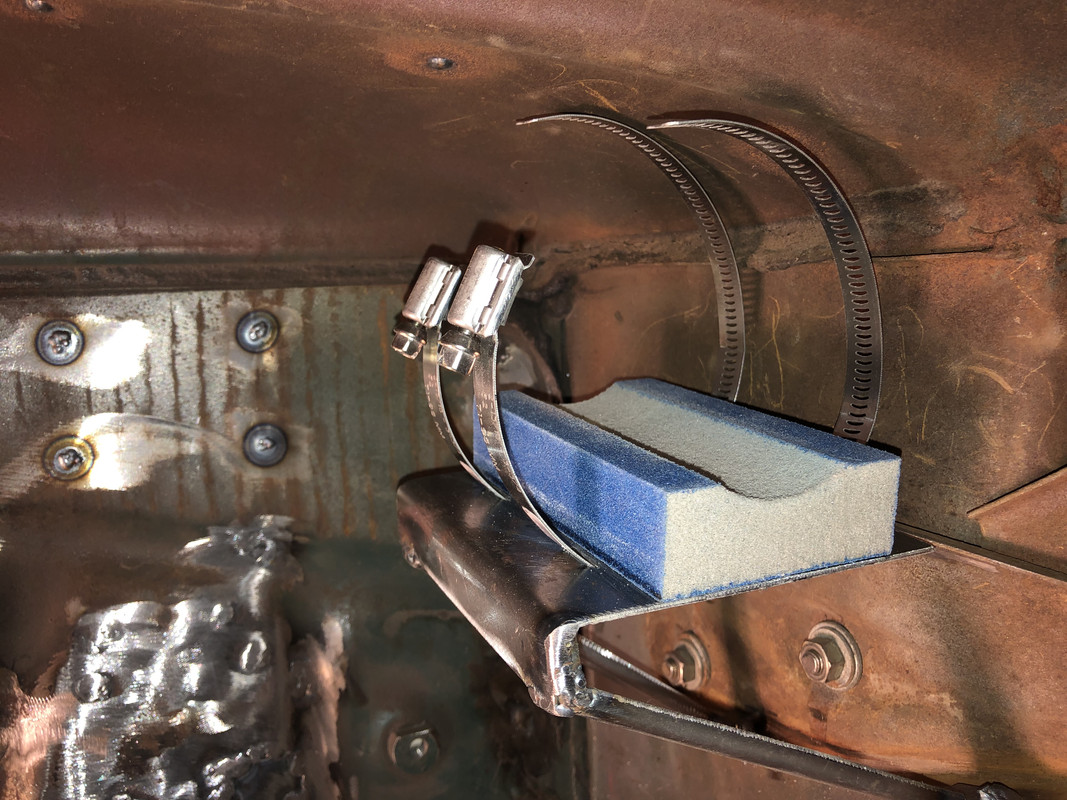

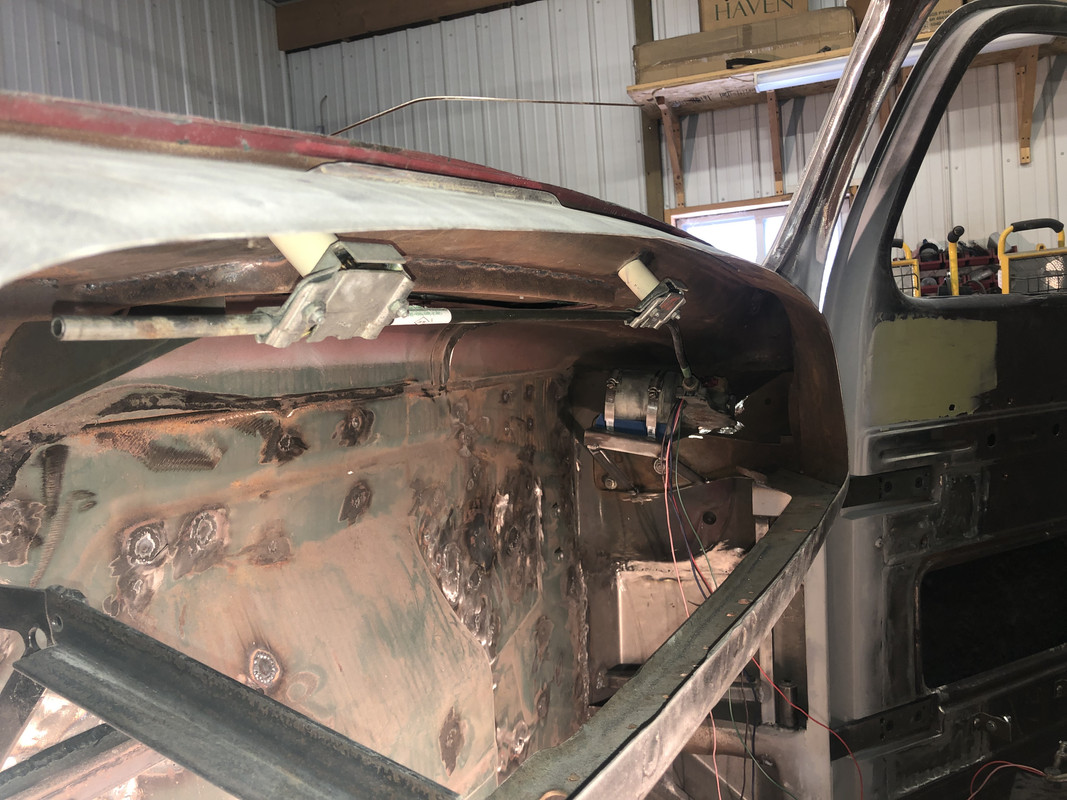

For the wiper system on the F1 I decided to go with a system I have used on other projects that I knew well. It is used on many classic British vehicles such as Mini, MGB, Triumph etc...
As I was completely re-doing the dash I had easy access so installation was straight forward as you can see below. Still plenty of space to install the Vintage Air AC unit. Worked well, bought from EBay for around $100.
Made a shell to hold the motor and welded into space into the passenger side dash area -
Mounted the wheelboxes at what I hope to be the correct angle for the wiper arms to the windscreen -
Cut and shaped the tubes between the motor and the two wheelboxes -
Powered up and tested.

Nice set up but looks like that pivot could have been placed a little more to the left..

There is no pivot? It is cable driven?
Old Dec 23, 2018 | 09:49 AM
56panelford's Avatar
56panelford
Posts: 283,924
Likes: 8,374
From: northwestern Ontario
The wiper arm pivots from the cable mechanism and looks like it doesn't sweep the full windshield to the left..
