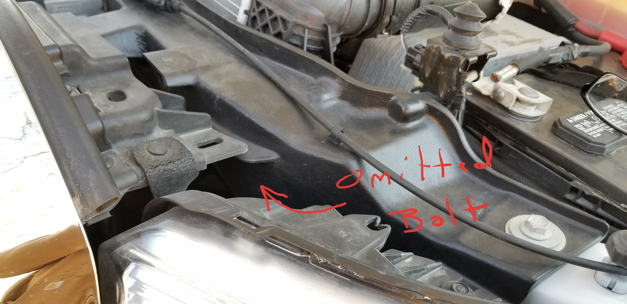

Is there a picture of where this bolt is supposed to not go? My '16 factory radiator and factory replacement appear to have all bolts present and accounted for but I'm not sure where to look.

Drivers side top bolt where the secondary is fastened to the primary is omitted.

That picture was taken during reassembly. I verified on my truck looking through the grill.

Thank you, that's not where I was looking. My bolt is indeed omitted.

Thanks for the image. My 16' had that bolt omitted as well.
For anyone that still doesn't know where to look, here is a wider angle. The bolt would be visible just above the driver's side head light assembly on the forward side of the radiator.
