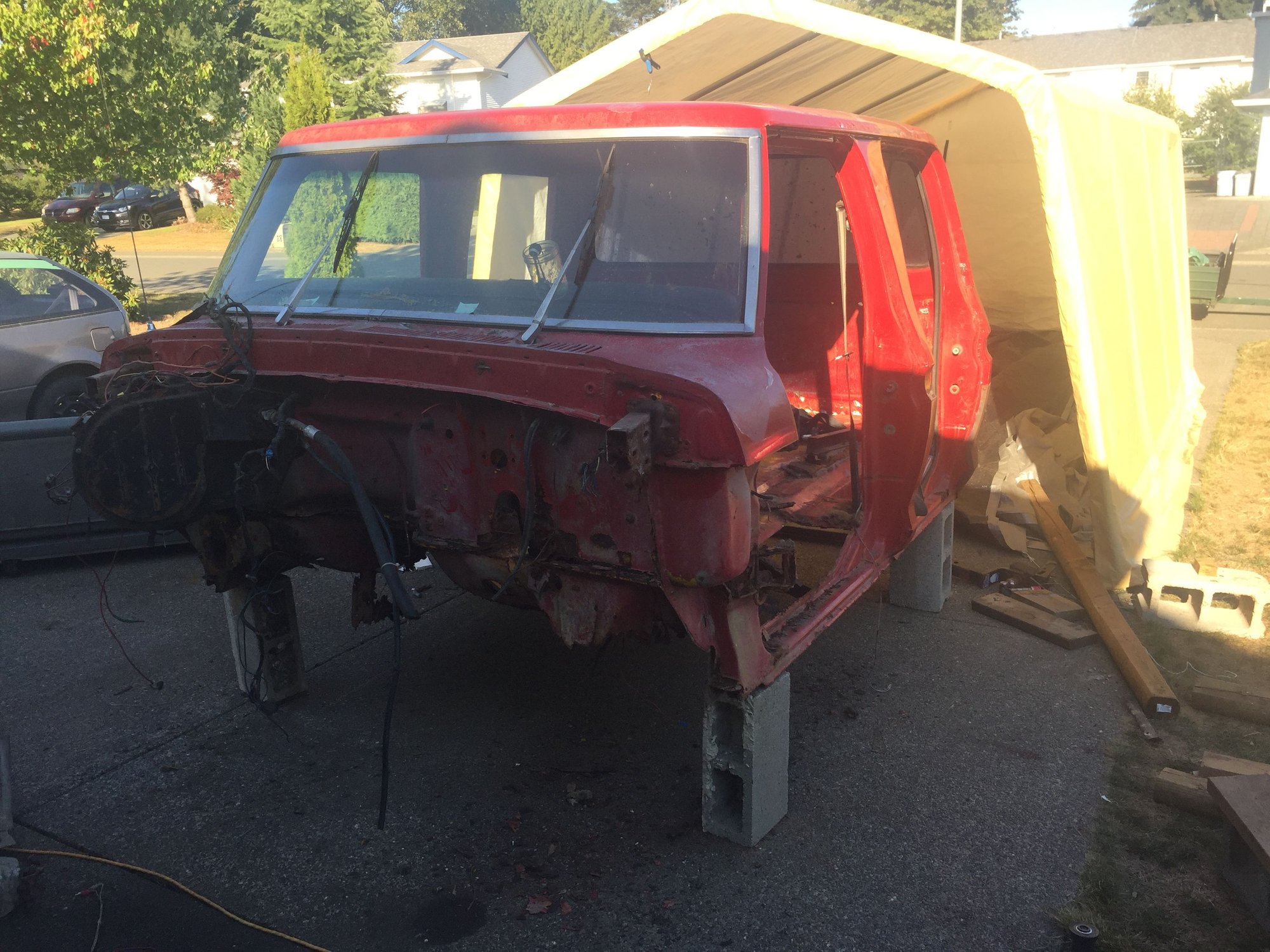

Hello
i recently was given a 1978 crew cab with a 460
i have stripped it down to just the cab sitting on blocks, the frame and motor have been sold as it will be getting a 4x4 chassis and a 12valve cummins
the floor is almost completely gone and I’m wondering if anyone knows where I can find a full floor or if anyone has spec sheets for the floor so I can build a new one?
thanks

Aw.. that'll buff out... jk..
is it confined to the front? I've been hearing good reviews of the Tabco replacement panels.

Not completely but the back is fairly easy for me to fix as it’s mostly flat
i have never heard of tabco but I’ll google them

It appears that Henry painted it yellow, and a previous owner painted it red. Must be an old highway department truck or something.
You want the thickest panels you can find. Most available replacement panels are thinner than original.
