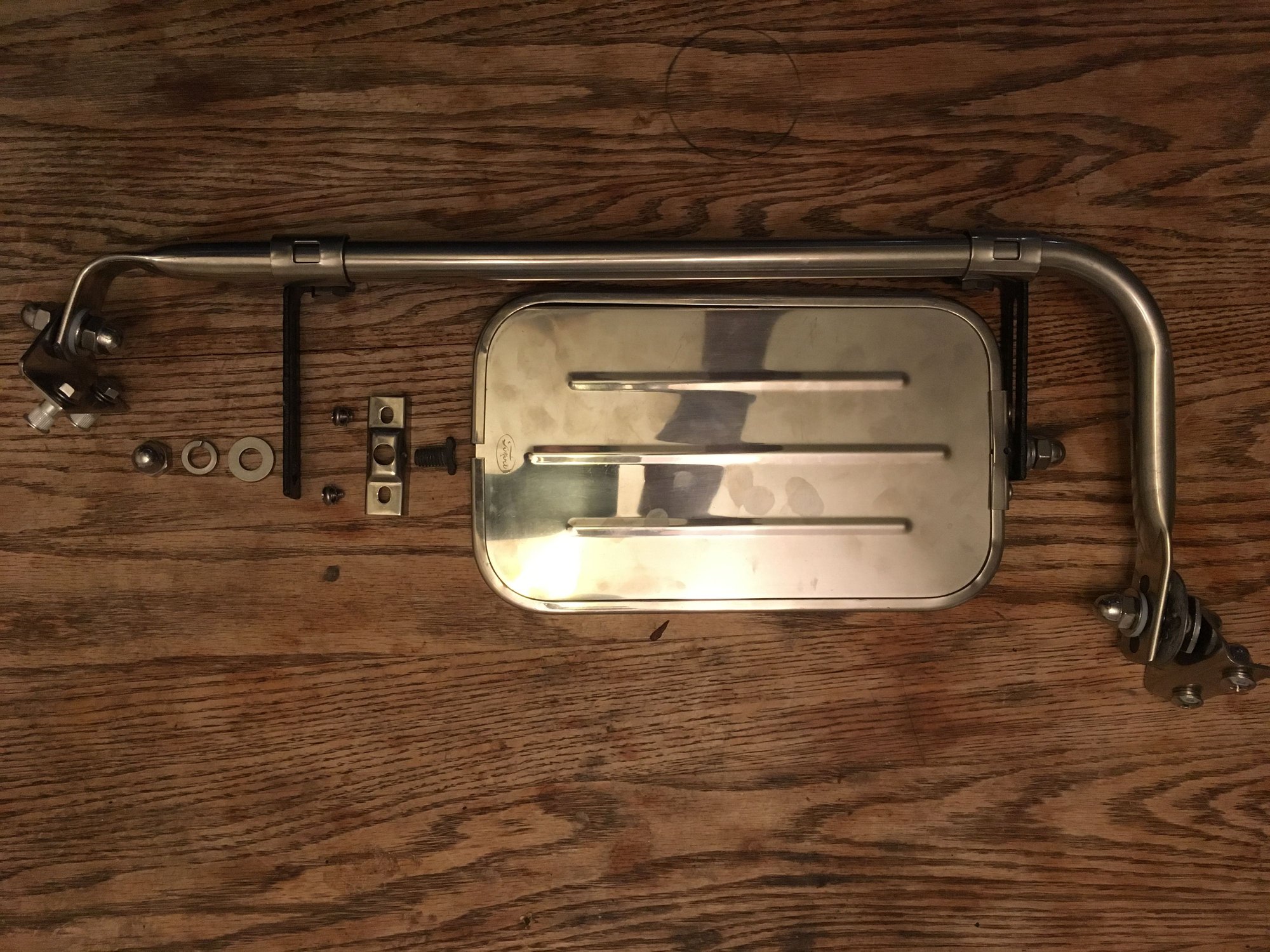

I have the Swing-lock Western Jr mirrors. Can anyone help me ID the tee-bolt that sits on the top and bottom of the mirror, pointing away from the mirror, that attaches it to the mirror brackets? Also, does anybody know if it is possible to buy replacement brackets? Mine seem to be home-made from the PO. (not the tee-bolts that connect the mirror frame to the top of the door)

If I am correct what you are talking of, is it the tab at the top/bottom of the mirror head that two screws are used to hold the clamp around the mirror.
I'm guessing you will have to find some junk mirrors and scavenge parts.

Thanks for the help, I'm looking for the Tee-bolt that 373231-S sits on top of.

This is a washer that fits on the studs of the mirror head, there is no T bolt in this location.
The only T bolt is located at the top inner of the upper door frame, retains the upper brackets.
Click on the pic twice to enlarge it, then look for basic part number 17386

NumberDummy, I don't doubt that I may have a mix of parts for my mirrors, they look like the 2-arm mirror in the picture above, but with the door-mounting brackets from the 3 arm version. The mirror brackets were home made by the PO.

The t bolt you are looking for Ford only serviced with the mirror head. Look close to the top and bottom of the mirror head in Bill's pic. Attached to that head you will see the parts you are looking for.
